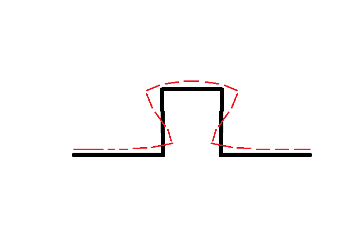

Let's start with a buried double wall pipe. Let's say the carrier pipe is hot and the encasement pipe is cold. The former expands, the latter contracts. Thermal expansion loops are integrated in the system at calculated pipe span lengths to avoid interaction between inner and outer pipes (clashing) near changes in direction. Using AutoPIPE (or similar piping software), fictitious restraints (with gaps) can be added between the inner and outer pipe at coincident nodes near these changes in direction to verify that no load is getting transferred between the bends of the inner and outer pipes (and hence, no inner pipes will virtually pass through their encasement pipe).
Here is the problem: With a contracting outer pipe and an expanding inner pipe, a large number of expansion loops are needed (in areas where they will not fit, in some cases) due to the limited span length calculated based on the gaps between the pipe and the amount of thermal expansion.
So I pose the question: What if we allowed the carrier pipe to bear on the inside of the encasement pipe? Is there any guidance for this in B31 codes? I imagine that concentrated bearing loads will develop unwanted stress concentrations, but at what point of loading is this deemed an unacceptable level? Is this a bad practice? Is this left to the designer/engineer/owner to determine?

This is a real system that has a 3" inner pipe carrying hot water (~200deg F) and vertically supported (with supports connected to outer pipe) in a 6" outer pipe. Owner requires a low installation temperature of 60deg F for pipe stress analyses, so we're looking at a 140-degree thermal delta. Only air between inner and outer pipe.
My thought regarding the inner pipe bearing on the outer pipe is that it seems to me that stresses in the inner pipe would be relaxed (a certain amount) since the outer pipe is bearing against the soil which has some flexibility (compared to a concrete anchor). The fabricators of this system will not be allowed to hot-spring weld the pipes to each other.

Then it will also be possible that the this will be overstressed during operation, or you may buckle the inside pipe and get your bearing on the inside of the carrier pipe, whether you want it or not. Or the 3" will have a lot of lateral spacers to prevent buckling, or your 3" will have extremely thick wall.

So in essence you have a 3" pipe on simple supports, just that your freedom of movement is limited to the bend ID. Unless your supports are really low friction the system will become restrained over long distances (150m?) and if it doesn't buckle then you could run long distances with only an end displacement based on a relatively short distance.
If you used a proper spacer / spider at suitable intervals (3m?) then you should be able to run very long distances in a straight line with support in all directions.
At the bends you might need to go to a bigger pipe size just for the bends to allow it to move axially, but is that a big problem?
Unless you're doing this as a double containment type of thing, I'm puzzled why you're going to the expense of a pipe in pipe system and not just insulate the thing??

You are right on with your understanding of the hot guided pipe sliding inside a cold "tunnel" pipe. We need expansion loops approximately every 41 feet (according to our calculations so that the inner pipe does not bear on the outer pipe). This is for a 3" STD carrier pipe and a 6" STD encasement pipe.

Then why on earth do you think you need to model the outer pipe? If there is no touching of inner to outer pipe, other than friction, you have only to model the hot pipe sliding on some kind of support, wherever you have located the spacers. No need to consider the outer pipe at all. Just sure the outer pipe is large enough to accommodate the expansion of the interior pipe without allowing any touching.

Care to elaborate? I get a 140F expansion on 41 ft length of pipe to be max 0.5" total. At either end you have 1.5" min before you hit the outer bend at each end so 3" in total.
If you know your issue is expansion then don't centre the inner bend in the loop so can get another 1-2" easily. I would model a very long length of straight pipe ( say 2000m) and see what happens if you fix one end and let the other end float. My guess is that the pipe will eventually stop expanding and "lock up". Then look to see how you can deal with the end expansion or at any bends.

There is a kickout tendency at the top of the loop which gives the bends both X and Y displacements, or if kickout is restrained, can increase friction on spacers near the bends. Could depend on how tightly the carrier pipe is held within the casing.
