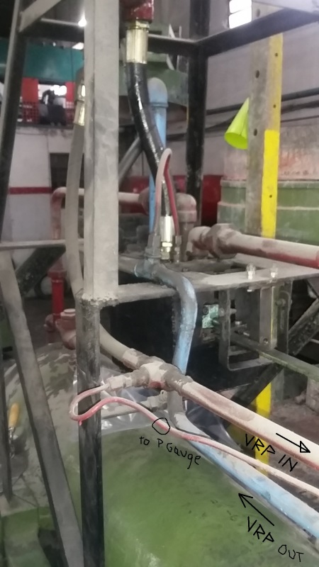

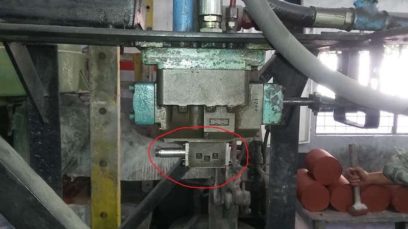

picture attached. what is the little valve below (circle in red)?
RE: Directional valve problem

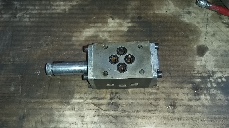

Without knowing the full history of the setup and just going on the picture...
The small valve is the pilot valve that once operated the main valve. Someone has converted a pilot operated valve to a manually operated valve.
Much more data is required to diagnose your problem.
It could be that main valve spool is being affected by the flow forces of oil coming from the cylinder, but looking at the valve size, it is doubtful.
The pilot valve is single operation, just one solenoid that would have sat on top of the silver barrel. It is possible that your tank line is seeing high pressure and that high pressure is being fed to end of the main spool, via the pilot valve. That will push the spool and it may be why you are seeing the this issue.
I know you say that it's worked this way for 10 years, but if the tank line is blocked or if a return line filter if blocked, the pressure will increase in the tank line.
On the assumption that the pilot valve connects its A or B port to tank, where the tank pressure increases, it could over ride the manual signal and push the spool.
Lots of assumptions, hence we need more data. A picture of the underside of the valves would be good.

Question: is it a " plugged connection" at the left of the valve in the "red circle"? And, what's it for?

I'm guessing the pilot valve solenoid failed and was disconnected long ago,
and now its return spring has failed also, so it's fighting the manual
operator on the main spool.

Your valve started life as a spring-offset two-stage solenoid operated valve. The little valve circled in red is the solenoid pilot valve which has had its solenoid removed. It then looks like one end cap has been modified to convert the main stage of the valve to manual operation. However, the spring offset pilot valve will still be directing pilot pressure to one end of the main spool continuously hence the reason it is difficult to move the spool in one direction.
You could do a bit more modification to the valve to overcome this then wait for a disaster to happen or you could buy and fit a valve that is designed to be manually operated. It's a standard interface so they are readily available.

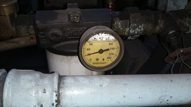

I forgot to tell you that there is an inline return filter on the return line to the tank and it has a pressure gauge.
Return line pressure is 30 psi, which is low to us, we change the filter once pressure has reach 40 psi. The filter change is done every 3 months approximately
I am thinking the the pilot valve lever has been move for some reason and that is what is causing the problem. Could this be?

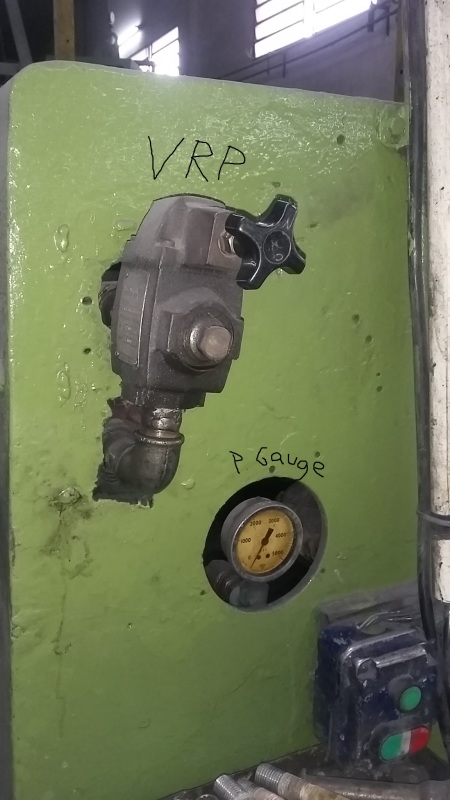

VRP: Pressure Regulation Valve (manually operated). It is used to regulate the force of the cylinder on the forward stroke

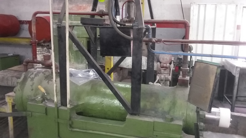

I will do my best to make a drawing of the installation tomorrow. I dont have time now
The directional valve is inside the black box

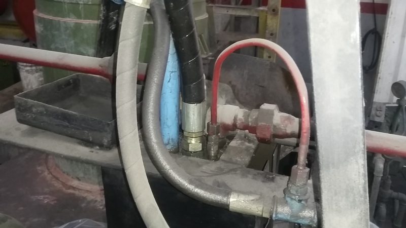

First thing to do is remove the pipework and replace it with tubing and fittings that are rated for the pressure in that system.
Assuming your gauge reads 2/3 of the full scale, you see 3000 PSI. The malleable fittings that I can see in the photos are only rated a maximum of 600 PSI.
I'm not going to be complicit in this. That system is dangerous if you are working it above 600 PSI, and that is again assuming that the fittings are heavy duty and not rated to just 200 PSI.
HPost:
Red pipes are the high pressure side and they are all rated for 3000 psi. Relief valve is set to 2000 psi
Working pressure is 800 to 1500 psi
Ligh blue pipes is the return line. Rated to 600 psi, Is it to much of a trouble to ask you to show me in one of the pictures what are the fitting your are referring because now I am worry too
Look at the fitting under the valve you have labelled VRP...
The welded fitting is a dead giveaway. The elbow is also clearly a low pressure fitting.
Who told you that the red pipes are rated to 3000 PSI?
You need to research Class 150 and Class 300 malleable iron fittings to see the difference in the pressure ratings and also the difference in appearance.

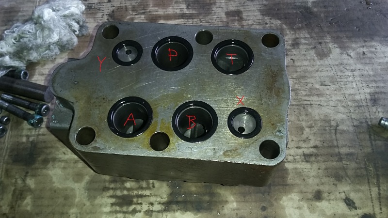

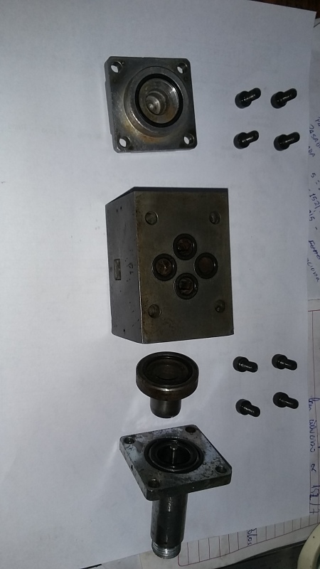

directional and pilot valve are dismounted for inspection and cleaning. We found that the pilot valve has been modified (like you said) long time ago. Pilot valve spool is missing (see picture)
We are about to reassemble the whole thing and test
What are ports X and Y for at directional valve?
The pilot valve is a CETOP 3 or NG 6 valve. It has only A B P and T ports. The A and B ports serve as the pilot ports that send oil to the main spool.
On the main spool, the X may be connected to the main pressure gallery or the pilot pressure may be supplied from elsewhere. The X port will connect to the P port on the pilot valve. The Y port will connect to the T port on the pilot valve.
There are cast identifiers on the side of the block (pilot valve). They will tell which port is which.
It is likely that your main spool is getting a pilot pressure from the pilot valve body. I'd suggest either removing the pilot valve and replacing it with a blanking plate. Or you can put a plug in the X and Y ports.
It will be worth checking to see where the pilot pressure is coming from. Either the X port or via an internal connection into the pressure port on the main valve.
It'a looking very much like you have an unwanted interaction with your pilot pressure. The fact that it has worked for so long may just be down to luck. Slight wearing of the spool can change the pressure drop across the spool and change the pressure acting on the spool lands and cause the spool to move unexpectedly.
You don't need any pilot pressure, so you should just blank it off.

X port is blocked
Y is connected to return
We just finish testing and now the directional valve works fine. We are making a blanking plate to replace the pilot valve and probably test it tomorrow
