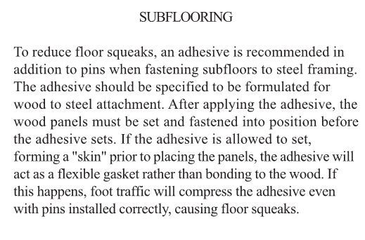

Stumbled upon this while boning up my CFM chops. From one of the CFSEI tech notes and in the context of pneumatic pins rather than screws.
Quote (cliff234)
I'll call some adhesive manufacturers and discuss.
Anything to report on that front?
RE: Can floor sheathing be glued to cold-formed steel floor joists?
KootK... in this case, the squeaking would be caused by the movement on the shank of the pin... Dik
Well...yeah. Isn't that pretty much always the case with sheathed floor squeaks? Hence the whole gluing and screwing business?
