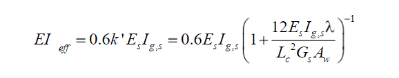

They're great references MrHershey!
Interestingly the 2010 Seismic Provisions document has an error in the effective stiffness formula for SRC beams. They show the formula without the exponent of -1, resulting if an effective stiffness greater than the basic Ixx value of the steel section. This error is eluded to in the dissertation by John Motter.
I understand the embedment length dictates how much shear the wall/beam interface can develop. If the embedment length is constrained such that it can only develop say 50% of the shear strength of the steel section, it's logical that it could only develop that same fraction of the flexural capacity?

Yep, so if Vn,embed is all based upon "a" which is half the clear span of the link beam, then the effective partial moment capacity is Vn,embed * a?
This is a bit more accurate than my previous statement, as you could have a really thick web providing a large shear strength of the section, but that won't help when you embed it a small distance.
