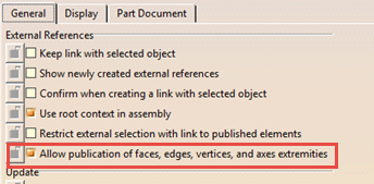

Why can I publicate anything besides body?If I try to publicate face ,message pops out selected element is not allowed for this operation.
RE: Publication
check tools options Infrastructure / Part Design:

RE: Publication
This option is on,so there must be something else.Thank you!

RE: Publication
can you extract a surface from the face, and then publish the surface?
RE: Publication
Quote (can you extract a surface from the face, and then publish the surface? )
Yes I can, it appears to me that this is the only way to do this.
