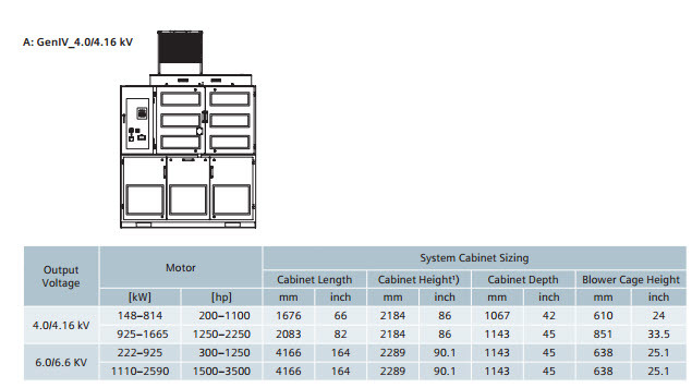

Hi Jraef,
500hp drive puts you into the smallest footprint for the Siemens M VASD (Gen 4). I am not sure if Gen 5 is out yet, but I heard that it has an even smaller footprint. Of course, Toshiba also flogs a similar type of drive, but with the option of an outdoor enclosure. I have used these in Northern Canada. Could be an option if you can't find any indoor space.
