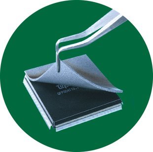

btrueblood, is it that hopeless?! ))) See what I just found (attached pic, it is from 3M, thermally conductive interface pad…), if provided at reasonable cost, this will do.. Do you have any idea who else has this at a reasonable cost? (Max continuous working temperature will be 100C)

Sound deadening is often achieved using a soft, lossy polymer filled with a high density mineral. Companies like BMW, Volvo, GM and many more use such materials. That means you'd need a high density mineral with high thermal conductivity. High density minerals include barium sulfate, magnetite and hematite. Of those hematite has by far the highest thermal conductivity of 12.5 W/m.K and a density of 5.2 g/cm3. It's hard to find it in pure form and milled to the right size to be a filler so I actually helped create that product and it was launched last year under the DenzFlex tradename. Note, I do not sell the product, nor do I make any money on sales. Magnetite has the same density but only half the thermal conductivity.
By using a high loading, typically 60-80 weight% of filler you should be able to get a thermal conductivity of the composite over 1 W/m.K. That's not a guess, it's what's been reported in articles.
