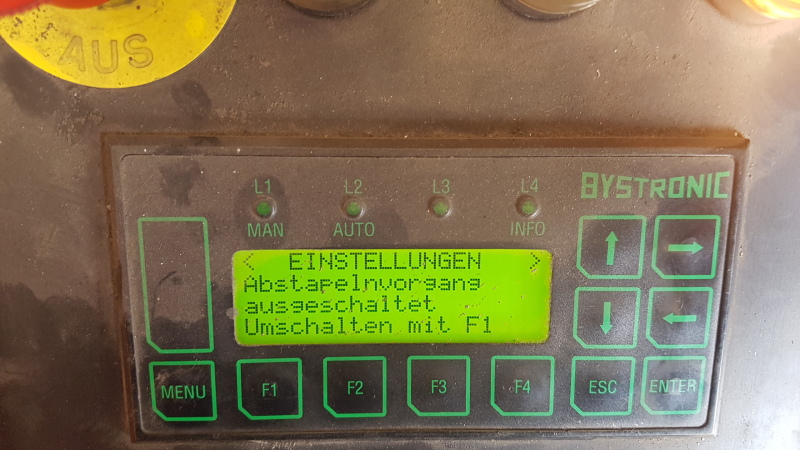

In our Bystronic MMC program setup, I'm missing one line: N42=Stacking: 0=off,1=on
This line is switched to on at the moment and when I cut in automatic mode, when laser finishes one program, laser stops waiting for stacking operation.
If I look in MMC setup or config hardware there is no such option how to disable it, but in config files this line exist
So maybe I could manually change config files in order to disable Stacking. Or how to make it visible in MMC?
Attaching config files of our laser.

I found solution to this problem, you need to turn this stacking on in Service menu - > Config cnc Bysort ankoppelung.
Then in setup menu it appears as separate menu unit where I can disable it.
As well in PLC unit new menu appears, where it must be disabled.

the bytube is quite a puzzle when it comes to setup values. make sure you record all the settings on the pedestal and make sur eyou do a SAVE EVERYTHING in the service menu. The hidden settings in th epedistal are accessed by jumping input 15 on the PLC to 24V, on th enewer machines they used a password I guess they figured out that going into the cabinet with a piece of wire and touching it to things might not be a good idea. the password is the 4 numbers for the schematic.
