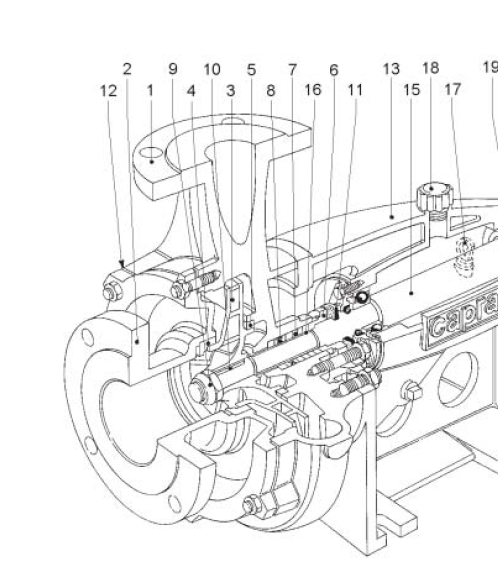

Hi Gents,
briefly, we got re circulation pump (D&S) (35 l/s 15.4m & SH-19m) for a tank capacity of 1500 cu.mtr with single suction & discharge (please find attached sketches. pump was giving 10 psi at discharge which was overlooked and modified the system to 8 suction &12 discharge as attached.
After tested, of course it has been found that field data not matched with manufacturer data.
crucial things is when the system reduced to very low profile as single suction and single discharge and pump was over sized, then why it gives low flow?
could anyone diagnose the actual error ( please be noted, velocity head and pressure gauges elevation also included in the calculations to obtain the tabulated results.
Thank you.

End suction centrifugal, pumping clean water with temperature not more than 35 deg C.(about & years of operation with single suction/discharge. Impeller pic attached, took after 6.5 years of operation.
Please find attached manufacturer curve, I would like to add that we have checked the rpm, running I/V in both condition and found constant as nameplate. And checked the impeller for cavitation and no sign of it. also no abnormal sound or vibration during operation.

Not easy to say for definite where to go here. Data implies that pump may be suffering from years of low flow and either got damage to the internal vanes or seal leakage on the wear rings between discharge and suction side.
How accurate / how did you measure flow rate?
Anything stuck in the volute / discharge / suction inside of your pressure gauges?
Can only suggest you try a pump re-build and test it on a separate skid to see if you get the stated performance. 7 years operating at low flow won't have done it any good.

Not easy to say from a distance, but all I can think is that you have some sort of internal pump re-circulation going on - hence the question about the wear rings or what the seal is between the inlet and outer parts of the internal working (items 4 and 5 of the cutaway of what I believe is your pump.
At a single system flow it looked like the pump was operating at minimum flow.
one thing - you have checked it's going the right way around have you? I mean actually you not someone else.
