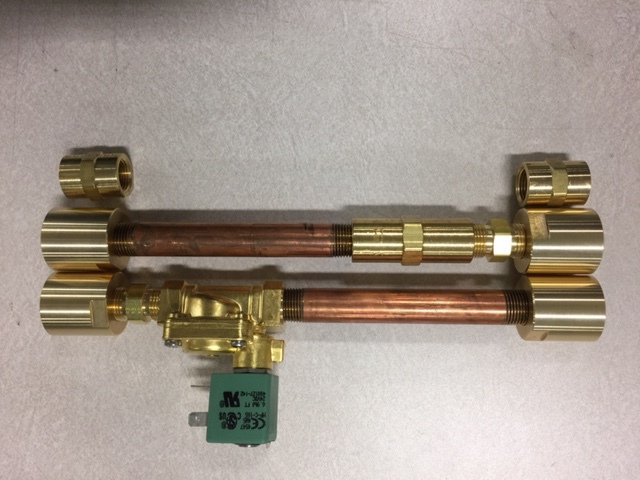

EdStainless, I thought we were buying premium fittings with these. In the meantime, here is a picture of the custom ones I had made. The originals are shown as well. The nipples are brass, they don't look it though.

Borrow an Enerpac pump and see if you can get even one of those fittings to 3900 psi without a failure. I doubt it. It looks like a generic 150 psi fitting.
The nipples appear to be 'red brass', a common alloy for pipe.
Given any number of field failures, I'd be using forged fittings, at least just for that one customer. I'd guess they're applying a moment load to the fittings, and I wouldn't expect them to admit it.
Can you show us how a moment load applied to the fittings would interact with your box?

There is no external stress on these assemblies. The two assemblies shown in the previous picture are contained end to end in a box. There are male fittings that connect to them through the box walls.

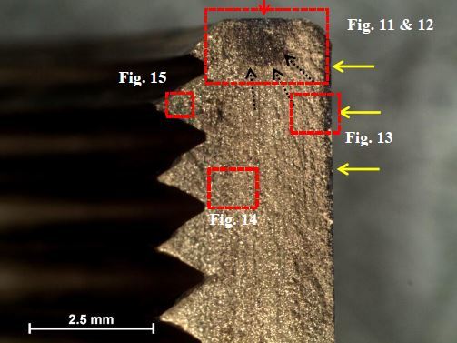

This is the summary from the lab analysis:
Two assembled water line control box couplings and three unassembled couplings were submitted for analysis to investigate the cause of cracking in five of the seven couplings. Results of the examination indicated the cracks were due to stress corrosion cracking (SCC). An intergranular fracture path was found on an opened crack fracture surface and in a transverse cross-section taken through a second cracked coupling. The cracks appear to initiate at the end of the fitting and propagate faster along the outer diameter (OD) surface. Crack propagation faster along the OD surface indicated hoop stress drove the propagation.
Energy dispersive spectroscopy (EDS) showed traces of chlorides and sulfur, which can be part of compounds known to cause SCC in copper alloys. The presence of other chemicals known to cause SCC in copper alloys, such as ammonia and certain nitrates, cannot be detected using EDS.
The only thing I don't get is they are saying the cracks initiate at the end of the fitting. There isn't fluid there to cause the SCC to begin with and there is no fluid on the outside of the nipple until it is cracked and leaking. However the report is very thorough with photos showing more corrosion at the outer part of the crack

MM: That's certainly possible but the nipples look very clean when they arrive from the distributor. We have never considered that we should clean a standard brass fitting prior to assembly. But that is something to consider, prior exposure.
Tmoose: We have discontinued the product and are only in the maintenance phase with it now. We stopped producing it because we didn't want to continue making something that would not work long term. I helped the customer find a different way to do the same thing. The only fix is when we receive a set back to repair we replace all 4 of the nipples with the custom versions we had made that are way bigger in diameter (see a few posts above). We have only done one like that so no data on fails there.
