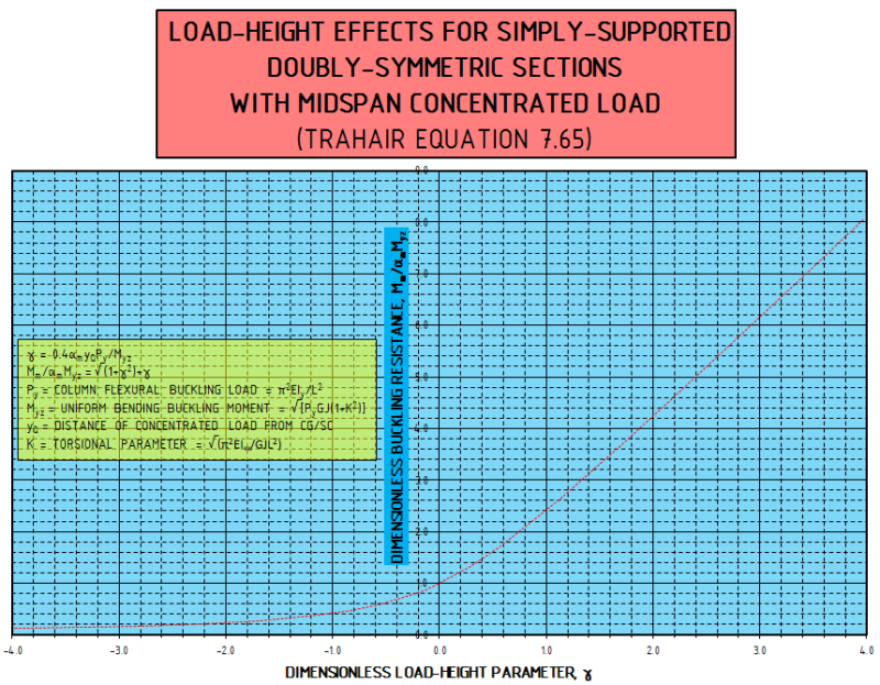

Using Trahair's approximations: For a W24x55 (doubly-symmetric section), I calc a factor of 1.31 assuming midspan concentrated load applied at the bottom flange, compared to a factor of 1.0 for load applied at shear center, and 0.76 if the load is applied to the top flange.

Interestingly, at today's AISC live webinar Link on the design of underhung cranes the subject of load-height was obviously discussed. The presenter, Lucas Pachal, presented the SSRC 4th Edition method and directly used calculations with the SSRC MODIFICATION, as follows:
In the SSRC-4th Edition method, the "beam parameter", W, is identical to Trahair's "torsion parameter", K, so both methods yield the same result.
If you apply the SSRC MODIFICATION method, it assumes a constant load-height factor of 1.4, disregards the type of loading (distributed or concentrated) and simply modifies the bending co-efficient, Cb, so something like this:
