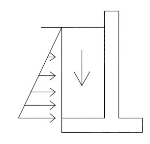

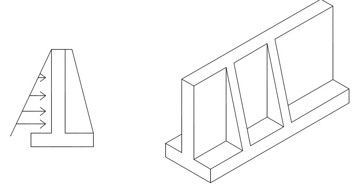

Looking to see if anyone has some tips/ideas to design the unrestrained basement wall as seen in the attachment. My initial design was a retaining wall. Like a typical project in the design-build field, the contractor thinks this is nuts and way overdesigned. Per the usual, they did not have this amount of concrete figured in their contract and are super concerned about cost. After talking to their concrete subcontractor (due to lack of belief in the engineers design), the subcontractor believes (2) pilasters extending 4' into the soil as denoted in red will be sufficient to brace this wall. I took this approach and looked at the wall spanning as a continuous beam and used the pilasters as supports. The force at these pilasters becomes very large and to prevent overturning and sliding the 4' length will not work. I assumed this would be the case and the length required becomes extreme and I will hear major push back from the contractor.
I have thought of other possible scenarios that may work:
1. Span wall the 36' between cross walls (unrealistic due to reinforcing and depth needed)
2. Place steel beams on the outside of the wall and somehow tie to the basement wall (beam would span horizontally to cross walls.)
I know my design is not dictated by the contractor that had overlooked this when bidding, however I want to give the most efficient and cost effective solution possible. I am at somewhat of a lost on this. Any ideas would be greatly appreciated.

Why not to place an L shaped retaining wall? Instead of a rectangular foundation use the soil weight to avoid overturning.
RE: Unrestrained Basement Wall
This was my initial design and the customer and sub-consultant think I am nuts after I gave them the size of footing and wall required. They both think this is a typical basement wall with a restrained top.

Under your original design, the vertical steel is the primary reinforcing steel, and the horizontal steel is just designed for temp & shrinkage.
Once you put the two counterforts in, won't you have to increase the size of the horizontal steel significantly since you will now be relying on it for flexure? Can the vertical steel then be reduced in size?
It all kind of seems that you end up in the same spot cost wise?

What about something like this
Check all of the basement walls. Although your sketch does not show it, each basement wall may have the same problem.

I don't see how overturning is resisted in your first sketch. The bottom of the wall is pinned at best and there appears to be no restraint at the top of the basement wall other than an exterior wall dumping wind load onto your foundation. I do see how its resisted in the sketch in your second post. Adding pilasters could work in one of two ways. Either there is a big enough blob of concrete at the pilaster to act as a counterweight to overturning or you could design the wall to span horizontally between pilasters.

Another great idea. This was brought up and mentioned already as a viable alternative. However, this was shot down as nothing can be placed on the interior of the building due to usage.
This project like the ones we all dread really tests ones patience with customer/contractors. Give numerous solutions that are viable and get rejected as this will not work per their requirements.

Quote (Pioneer)
Yeah, that was always going to be a dud of an idea cost wise. Gracious of you to entertain it though.

I can get the pilasters to work, but they become much longer than the 4' that the contractor is proposing. When I did my design, I assumed the wall spans across the pilasters (continuous beam) and the forces become rather large at each pilaster. Connections between this perpendicular connection will become ugly and I am sure the client is not thinking of this either.

Any pilaster or counter-fort strategy will place great demand (requirement for) substantial footing size and cost.
I think the "cheapest" solution will be to run a couple of steel "wind columns" full height (as you mentioned).
If they could live with the 4 ft high pilasters, the full height wind columns might not be too much more intrusive.
