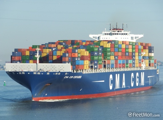

It looks to me to be a combination of errors:
> The bow portion of the ship hit the crane; as shown in the photo above, the bow section bulwark significantly overhangs the hull at that point, so it's possible to get part of the ship well past the edge of the pier. This is clear due to the ship moving WAY TOO FAST. A cruise ship would have taken much longer to get that close to the pier, and any bow overhang of the pier would be noticed and corrected immediately.
> The crane is possibly out of position compared to the rest of the cranes, which are much further sternward.
