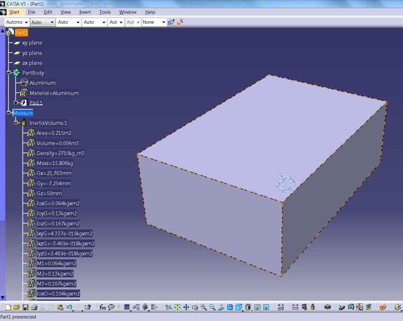

Hi
Short example, hope I understood what you want to do.
CODE --> CATScript
Language="VBSCRIPT"
Sub CATMain()
Dim partDocument1 As Document
Set partDocument1 = CATIA.ActiveDocument
Dim part1 As Part
Set part1 = partDocument1.Part
Dim product1 As CATBaseDispatch
Set product1 = partDocument1.GetItem("1")
Set product1 = product1.ReferenceProduct
msgbox "Please select a parameter in what InertiaVolume you want to use in spec. tree "
Set Selection = partDocument1.Selection
Dim InputObjectType(0)
InputObjectType(0)="AnyObject"
     Status=Selection.SelectElement2(InputObjectType,"Select an element",false)
     if (Status="Cancel") then
         Selection.Clear : Exit Sub
     end if
     Set myselection= Selection.Item(1).Value
InVol = myselection.name
strLastName = Trim ( Mid( InVol, Instr(InVol, "\")+1) )
SplitPath = Split(strLastName,"\")
MyInVol = SplitPath(Lbound(SplitPath))
msgbox "You will use : " & MyInVol
'material user parameter
Dim parameters3 As Parameters
Set parameters3 = product1.UserRefProperties
Dim strParam4 As StrParam
Set strParam4 = parameters3.CreateString("Material", "")
strParam4.ValuateFromString ""
'~ Dim part1 As Part
Dim relations3 As Relations
Set relations3 = part1.Relations
Dim formula3 As Formula
Set formula3 = relations3.CreateFormula("Formula.7", "", strParam4, "PartBody\Material ")
formula3.Rename "Formula.7"
'volum user parameter
Dim parameters1 As Parameters
Set parameters1 = product1.UserRefProperties
Dim realParam2 As RealParam
Set realParam2 = parameters1.CreateReal("volum", 0.000000)
realParam2.ValuateFromString "0"
Dim relations1 As Relations
Set relations1 = part1.Relations
Dim formula1 As Formula
Set formula1 = relations1.CreateFormula("Formula.5", "", realParam2, "InertiaVolume.1\Volume ")
formula1.Rename "Formula.5"
'masa user parameter
Dim parameters2 As Parameters
Set parameters2 = product1.UserRefProperties
Dim realParam3 As RealParam
Set realParam3 = parameters2.CreateReal("masa", 0.000000)
realParam3.ValuateFromString "0"
Dim relations2 As Relations
Set relations2 = part1.Relations
Dim formula2 As Formula
Set formula2 = relations1.CreateFormula("Formula.6", "", realParam3, "InertiaVolume.1\Mass ")
formula2.Rename "Formula.6"
part1.Update
End Sub
Regards
Fernando
