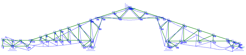

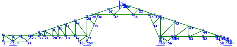

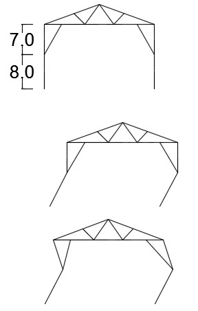

The truss shown below sets on top of a 2”x4”x8’ wall with studs 16” OC; so the bottom chord is around 15’ off the ground and the truss supports are 8’ off the ground. The truss shown is one of a series of trusses set on 24” centers. The bearing wall is freestanding for 14’. Thus there are 7 trusses exerting deflection or lateral force on the freestanding wall. At the ends of the freestanding wall are lateral wall set at 90 degrees which form part of the room. The calculated lateral loads are beyond the capacity of dual 2x4 cap plate and deflections seem excessive. Shown below are 3 examples using a different combination of support connections and the resulting deflection and lateral loads.
QUESTIONS:
1. What combination of support connections should be considered for a freestanding wall?
2. How can the high lateral loads or excessive deflections be addressed?
Note: I substituted a 6”x15# wide flange as a cap plate and a lateral loading of 340# on 24” centers exceeded the capacity of a 6”x15# wide flange. Max Unity Check = 3.6.

1) The first two sketches are essentially the same solution.
2) I believe that the correct, and conventional modeling assumption for the design of the truss would be to represent it as pinned at one end and roller supported at the other.
3) Modeled as described above, the only place that you may see trouble with the top plate is close to the perpendicular walls at the ends of the run where the top plate may be restrained and, therefore, in a position to attract thrust. This is a common issue with scissor style trusses and, frankly, just never seems to actually cause any issues. My guess is that the roof and ceiling sheathing ends up keeping things in check rather well. A more sophisticated model that captured the interplay between top plate flexibility and truss flexibility would also probably yield more reasonable results.
4) Your first step towards stiffening this up probably ought to be running webs from 4-16 and 8-13.
5) Your lateral deflections are only about 1/4". I consider those numbers to not be too bad for such scenarios.

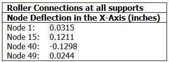

Everything sounds good except I need a little more clarification on deflections. You had mentioned the conventional model would be one pinned end and one roller and yes that is what I had learned also. However, the deflection with that scenario is not .25” as mentioned in your response (5) but rather .5” as noted in the 1st table. It would seem that .5” deflection would be a concern. In other words the wall would bow 1/2 inch in 14 feet. Concern? Yes/No?
Yep, the 2 trusses at the ends of the wall would pick-up the full lateral load as shown in 3rd table. I have not looked what it would take to reinforce the lateral walls but presently don’t think that will be an issue.
You know, the more I think about it now, the full deflection will occur in the center of the wall and the full loads will occur at the ends of the wall and there will be an incremental transition from the deflection to lateral load for those trusses which are placed incrementally closer to the ends of the wall. So lateral loading does appear to be a consideration, especially for those 2 and maybe 3 trusses closest to the ends of the wall.

Quote (OP)
That's why I mentioned that #1 and #2 are the same in practice. What you have is 0.5" separation across the truss. It's reasonable to assume that will manifest itself as 0.25" at each end. A tolerable value in my estimation.

Thanks for sharing the approach view. But as i understood this, your structure is havely unstable.
Your supports doesn't really have much lateral rigidity. You'll get second order analysis implications. Such as P-Delta effect.
The third picture represent a higher mode of vibration.
If you want to model this take into account the wall stud, both pinned at bottom and the truss connected to the stud.
Your main lateral resistance will be given by the roof diaphragm supported by the lateral walls which will have their own deflections. Those are the support you need to represent.

how did you get the roller-roller model to run ? it should be unrestrained in X. or did you add an X constraint on the CL (say at the peak) ?
RE: What type of Truss support connection should be considered in calculations?
he placed a pinned support at top side

99% of us would I think model the supports as pinned/roller. A sensible question is "but both ends are built the same way. why are they different (in the model) ?" Well, you can make them the same, only not pinned/pinned (as this sets up an unreasonable reaction due to the immobile constraint point. The "best" model would have both ends supported by a finite stiffness, allowing a small displacement at both ends (as opposed to zero with both pinned). If there is no side load, the Fx should be small.

Hey rb1957
By adding a roller at the apex of the truss, rotated by 90 degrees, I was able to run the case where all supports were set to roller. I used a roller because I didn’t want to restrict any vertical node deflection. I felt there would be negligible horizontal deflection at the crest of the truss.

Today I ran a full section case as shown below and the lateral deflections are minimal as shown in the table. (Yeah, yeah, I know, I still have more work to do to stiffen some sections; however, the maximum Y-Axis deflection of any node is 0.273 which meets the L/240 criteria for joists.) (Oh, you may notice the top cord of the center section is slightly higher than presented in 3 drawing of the original question. This was the original design and I dropped the top cord in an effort to improve stability and I have not made that change to the full section case yet. Nor have I added beams between nodes 27-38 & 31-35 as suggested by a few.)

should node 6 and 23 be co-incident ? or are you allowing the chords to workin bending ?
you need a member 22-24, or something else, to stiffen the obvious elbow joint.

Try with 26-32 as 2 members, both running on each side of the frame, then enlarge 6-38 through 26-32 and join 27 with the "new" 38. 6-25 doesn't need to be vertically disposed, maybe could be spaced near 26, shear should be taken into account in a different manner as normally programs does.
Perhaps a double members also could be useful running from 1 to 6-7 as an splice. But isn't enough by its own.
Are you planning to add members 26-39 & 32-34 as well as 27-38 & 31-35?
The structure is almost hinged at nodes 23, 26, 32 and 51. If it were completely hinged at those four nodes, the structure would be unstable. Even with the additional members mentioned above, you may want to consider the advisability of approaching so close to an unstable structure.
Have you checked vertical deflection at node 23 with unbalanced snow load?
