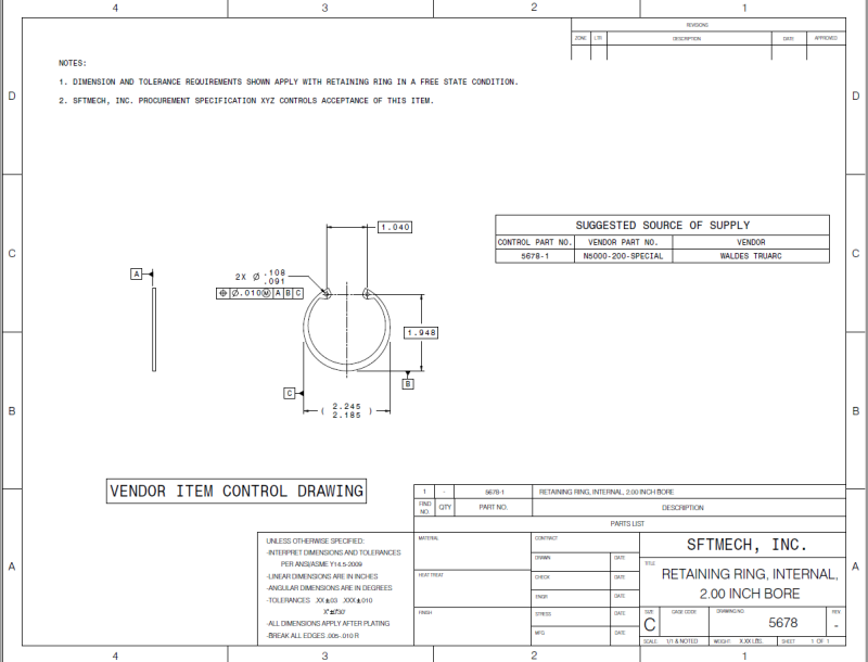

Hi all
For an internal snap ring with two grip holes that we get from a supplier, we need to control three dimensions and it seems hard that all of these parameters come right at the same time. The dimensions interested are: the horizontal inter-axis of the two holes, the vertical inter-axis between the holes and the center of the ring and the Ring diameter. There's also a spring back included.
regarding to the production method of the ring that I don't think that would be more than one method, is there any control method during production to apply to avoid these diameters go into discordance with the required?

If the bore G is correct, the lock ring will be snug in the groove when assembled.
If the Bore B is correct, the plier holes will be accessible after the ring is installed, AND the ring can be squeezed small enough to install, without the ends butting.
The attached image shows a dimension that directly controls whether the plier holes will be accessible after the ring is installed.
I think this is related to the dimensions you are questioning.
Are the rings you have received giving you installation problems?

@Tmoose: yes we got installation problems, There are grips to hold the holes. not so flexible. The dimension T doesn't guarantee the gap between the holes and their distance from the Ring center. The dimension T seems very hard to control, what method would you propose (despite that I don't think that it would guarantee the other dimensions)

The point I was making is that industry or mil standards for the type of retaining ring shown do not provide specific dimensional location control of the tool holes. Instead, each manufacturer can locate the holes where they choose, provided the ring meets all of the standard requirements. Basically what you're asking for is a standard vendor item with an additional requirement for location control of the tool holes. This situation is actually fairly common, and is typically handled using something called a Vendor Item Control Drawing. You can find an example of a Vendor Item Control Drawing in ASME Y14.24-2012 (fig.10-2).
If you look at the drawing example, you'll see views of a standard vendor part with some additional dimensional control requirements. On the right side of the drawing you'll see a table listing the vendor name and vendor part number for procuring this item. Before making this drawing, you will need to contact a vendor willing to supply a retaining ring conforming to your requirements. And most vendors are happy to do this. Tell them that you want their standard part with an additional requirement for positional control of the tool holes. Ask them for the hole location dimensions/tolerances they can meet in quantity for rings in a free-state condition, and dimension your drawing accordingly. The vendor will also provide you a custom part number for ordering this part.
Using a Vendor Item Control Drawing to procure your retaining rings will ensure control of the tool hole locations you require. It should not add much cost since you are not altering the vendor's standard design. Instead, you are simply asking for confirmation that the items delivered conform to specifications not defined in their published information for the standard part.

tbuelna Thank you so much for your super answer. while I have yet to understand its relation, that how it would help me. Yes we have our required dimensions that simulate the lifting mechanism that's very rigid. the holes could go out of tolerance due to manufacturing method. coiling. that's the problem
To help you understand how procuring your retaining ring using a Vendor Item Control Drawing approach will ensure the tool hole position is controlled and consistent, I spent 15 minutes making the sample drawing attached. The example part is a standard Waldes Truarc 5000 series internal retaining ring for a 2.00" bore. All of the reference dimensions shown can be found on their website. The basic dimensions and positional tolerance shown are for illustration purposes only, and you must get the correct values from Waldes Truarc engineering.
I hope this explains how this approach for procuring retaining rings will allow you to design an assembly tool that always interfaces properly. The approach does not require any changes to the tooling or manufacturing process used by Waldes to produce this standard part. Basically, all it does is ensure that Waldes (or any other vendor) does not deliver a "standard" part that has been modified in some way that will affect your existing manufacturing process/tooling.

Tbuelna thank you very much. Well in your example, you have displaced the plane B from the center to the perimeter. Does it change a lot of things?

SFTmech, the datun B makes a reference for a physical measurement rather than to a non-existant center point found by inference of a diameter.

Based on your previous posts it seemed that your issue was controlling position of the holes so that the ring could be grasped by the pins of an automated installation tool. Logically, the retaining ring would be in a free-state condition when it is grasped by the automated installation tool. So a free-state condition is what should be defined on your Vendor Item Control Drawing, and that is clearly stated in general note 1 on the drawing example provided.
The type of internal retaining ring shown does not have a circular outer profile in a free-state condition. It has a free-state outer profile designed to provide a uniform circumferential radial pressure and conformal fit with the groove OD when installed. Since the ring free-state outer profile (as shown in the drawing example) has no symmetry about a horizontal axis, there is no "center" location in the vertical direction. As hydtools noted, in this situation it makes sense to dimension from a physical surface. There might be a better approach for interface control dimensions than what I used in the drawing example, but I'm sure it explains the basic concept.
