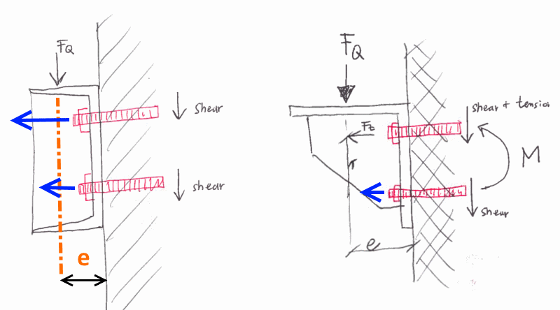

I have an existing RC parapet that is 150 mm thick.
I would like to anchor a steel support to this parapet.
Steel support (beam) is a bearing seat for a timber beams along a parapet.
I have two options. Id like to hear from you what do you think/suggest.
OPTION 1
I have steel C section + stiffener (at a spot of concentrated load from timber beam). As far as I can see, there will be only shear forces in bolts. Correct?
What is bothering me is a fact, that a flanges are very short with this kind of steel profile. So a steel C section with height of 200 mm has only 75 mm long flanges. I dont need such big profile (height of section so its not really economical to choose big dimension just because of that). How much bearing seat is enough in your opinion?
OPTION 2
Bearing seat is not a problem, but what I dont like is the fact, I get tension forces in bolts. That is a problem since existing parapet is only 150 mm thick. Also reinforcement in parapet is at minimum.
What do you guys suggest? Have I overlooked something?

Reaction/force FQ per timber beam is around 30 kN.
Timber beams are 1,10 m apart.
RE: steel support anchored to existing RC parapet
The load, FQ, is eccentric with both the channel and and the angle. The section tries to rotate about it's lower right hand corner. This puts both shear and tension in the two anchors for the channel and the two anchors for the angle. How the shear and tension are shared between the the two anchors can be complicated and depends on the hole size shape and location in the steel member. I've marked up your sketch, see it below.
In most cases 75 mm is adequate for a beam seat.
I would use an unequal leg angle sized (thickness) so that the stiffener is not required.
The longer leg of the angle is next to the concrete.
The unequal legs allow the bolts additional spacing for the concrete anchorage, and more lever arm for the bolts to resist the moment.
Not using stiffeners reduces the chance of mislocating it during fabrication or installation.
Load, FQ, from a timber beam cannot be very high when compared to the allowable load for the outstanding leg of a suitable angle.

SlideRuleEra thank you for elaboration. It make sense!
I am still kinda worried about parapet being only 150 mm thick. I have to check what are manufacturer's requirements for anchors.

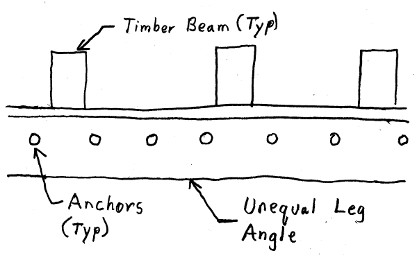

You are welcome. If possible, bolts that go through the wall are probably better than anchors.
Keep in mind that drilled holes for for either anchors or through-bolts may not go where you want them. For example, existing rebar may be in the way. In your design, allow for anchor relocation as much as possible.
A design that I have used is to have a single line of anchors spaced along the length of the angle. Then, the shear and tension on each anchors is more predictable. A heavy angle allows the anchors to be further away from beam centerline, yet still contribute to beam support. Also, relocating the hole in the angle (when required) is not a big deal. Still have to be follow manufacturer's anchor spacing requirements.
Here is a sketch of this concept, looking parallel to beam length:

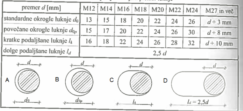

Would you guys consider elongated holes (horizontally) in steel angle, since the beam will be outside (exposed to change in temperature from -20oC to +40oC)
Steel angle (beam) is 7,50 m long.
I calculated that the expansion of the beam is 5,50 mm (for ΔT = 60oC).

IMHO, elongated holes... no.
Oversized holes... those should be used anyway, without regard to thermal expansion.
Retrofit work, like this, is different than new work. If the design is made strictly using new work practices, there will be many field problems that don't have a good solution.
For example, there is no guaranteed that field installed anchors (or holes for through-bolts) will be perpendicular to the concrete surface. In fact, many of them will be at slight odd angles... in multiple directions. Expect interference (in the vertical direction) with the horizontally slotted holes.
Another example, if an anchor has to be relocated (say because of conflict with existing rebar), it will probably be necessary to make a new hole in the angle. Then drill the the hole in the concrete through the hole in steel.
Along those sames lines, don't install the minimum number of anchors to carry the load.
In accordance with the anchor manufacturer's recommendations... install as many anchors as practical. Some anchors may not be usable. Also, since (by necessity) the design does not follow accepted practice for new work, the anchors should be as lightly loaded as possible.
Concerning thermal expansion, I agree with your 5.5 mm change. However, the concrete temperature is likely to be similar to the temperature of the steel. Thermal expansion coefficients as similar for concrete and steel. The concrete is not going to be -20oC at the same time the steel is +40oC. Maybe, say, 20oC difference, but never 60oC.
Also, it is unlikely the steel will be installed when the temperature is either -20o or +40o. Thermal expansion and contraction will probable be based on a more modest temperature. Say, installation at +20oC, with possible temperature changes being +20o or -40o.

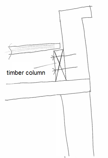

Can you not just put timber 'stub' columns beneath the beam? with a lag going into the wall for lateral tie?

dik - in that case Im dealing with the same problem as mentioned above. Id like a line support. A wall below a parapet/slab is 200 mm thick (parapet is 150 mm) so there is 50 mm difference. Maybe I can put timber beams on a wall/slab, but I dont really like that idea. I also dont want to load a slab in any way since I have no data about it but it looks in pretty bad shape.
However, I was thinking about why not replacing steel angle with timber beam along the parapet. This beam will be well protected from outside/weather (there will be plywood + hydro insulation above timber beams). But in that case Id need to place washers.
Because the wall beneath the slab extends a bit beyond the parapet, the load will produce little if an shear and normally slabs with a continuous support do not have shear problems. Just seemed to be the easiest and cheapest manner of support.

I'm with dick on the post down to the slab. Negligible slab impact there.

Concerning your question on bracket hole size. Oversize hole "B" in your diagram is what I have in mind. An angle bracket 7.5 meters long is probably going to have 40, or so, anchors in it. The chances of installing 40+ anchors in the wall (even using a full size, accurate wooden template) then being able to slip the bracket onto those 40+ anchors are essentially zero.
The only way to make this work, in my experience, is to mount the bracket on the wall with at least 2 anchors, then drill the remaining holes through holes in the bracket. I don't have current info on anchors... but say that 3/4" diameter chemical anchors are used. A hole perhaps 7/8" diameter needs to be drilled in the concrete. To do this the hole in the bracket should be, maybe, 1" in diameter.
Yes, the holes are oversized, and (theoretically) there could be some movement. However, in practice, each of the 40+ anchors will be installed somewhat off center or angled so that the bracket is wedged in place and could not be removed if you wanted to do so. Install appropriate washers and nuts, and try to make the bolting approach slip critical. It will not be slip critical... I know that. But if the work is done with care and attention to detail it will work... and will be successful.
