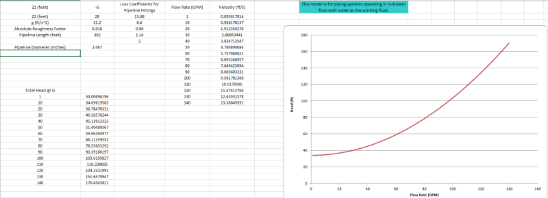

This is what I use. I make a system curve in excel, then lay it on top of the pump curve for any pump I may use for that system.

If you know the system then sure, but if you only have one data point. ...
RE: Pump expected flow from curve
Usually a system walkdown and/or isometric drawing review will give you everything you need to make a system curve.
