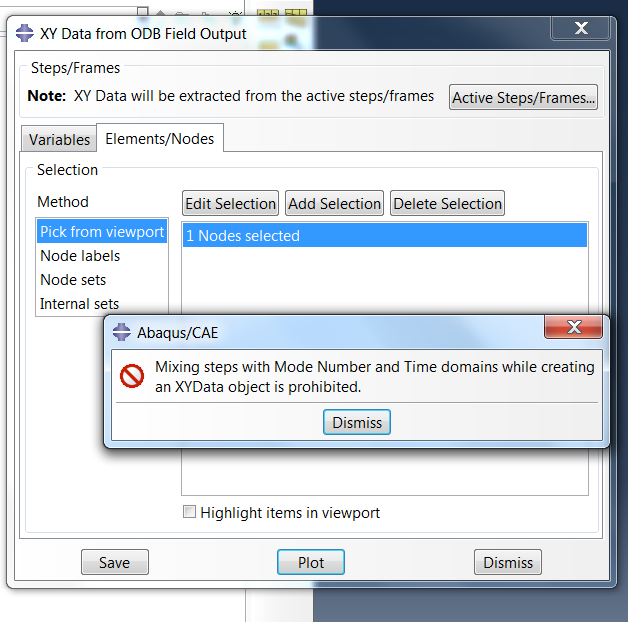

That's what I thought but whenever I try to create XY Data I get the following....
RE: How to plot freq response function for a node?
I assume you have other steps in the analysis, that act in the time domain. Use the upper right button in that dialog (or Results -> Active Steps/Frames) to deactivate such steps before.
Also think about complex results. Maybe you also have to switch the settings before. See Results -> Options -> Complex Form
Phew thanks that was driving crazy
