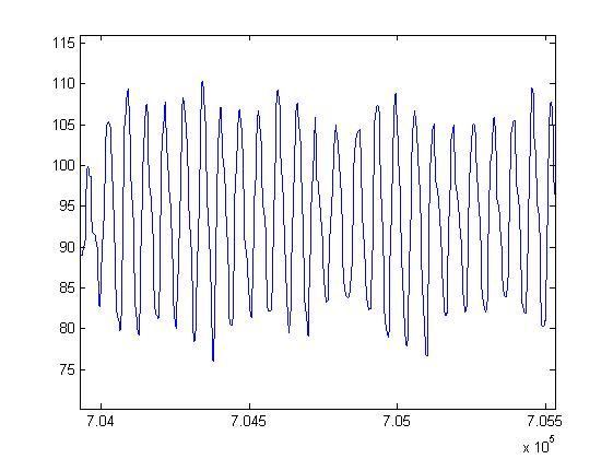

I want to implement the fast fourier transformation on an aperiodic signal, which you can see in the next picture:
The first question came here, can I use the FFT in an aperiodic singnal?

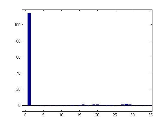

Once I execute the matlab code I obtain the output of the transformation, which you cant see in the next picture:
As you can see, the first value (DC offset) is correct and it corresponds with the offset of the signal, but the remaining values of the amplitude of the FFT does not corresponf with the real values of the amplitude of the signal, and the FFT notmalization is done. Why this colud be possible?
Thank you!

subtract the constant term in your FFT data and replot,
your amplitudes are fine,
RE: FFT real amplitude value
I think that there are not fine, look at the real amplitudes there is one in the range of 5 and that is not represent in the FFT amplitude values.

When you seek the spectral content of your data, the constant (or average dc term) is of secondary importance, so you remove it from the figure. What's left is the amplitude spectra absent the dc term.
As one of the earlier responders has suggested, windowing is encouraged, to avoid mis-representing the actual data stream.

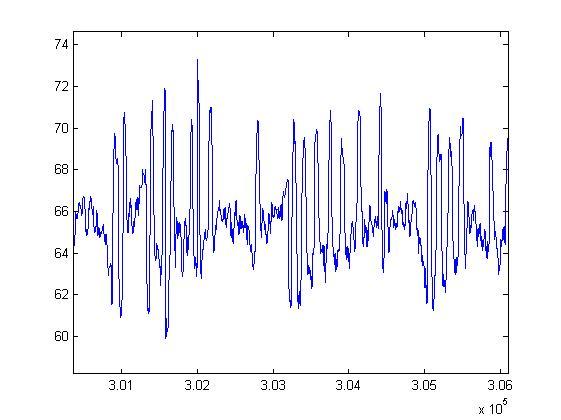

I think that both of you are correct encouraging me to use a window function to reduce the spectral leackage, but I understand that the window function depends on the frecuencies and the amplitudes that you have in your data. Have a look at the next pictures that represent two different periods of my signal. If you see them more in detail, you can notice that they have different frecuencies and also different amplitudes within the same frecuency.
That pictures represent only two of the vast amount of periods I have, so I understand that I have to use a different window function for each and also a different resolution (fs/N) for each to catch the real amplitude of the frecuencies I want.

Interesting that the n=1 component has the magnitude of roughly twice your dc average...
the autocorrelation should show the dc component clearly.
