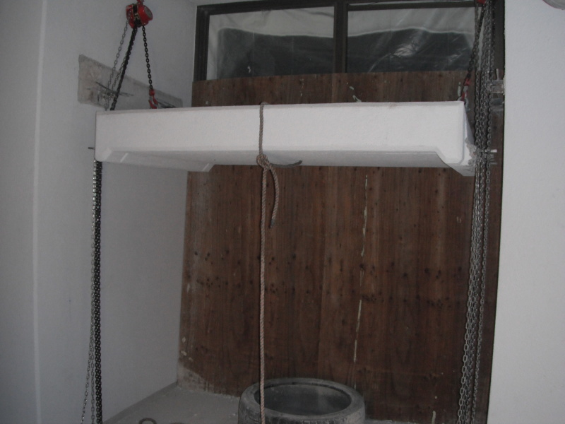

I am demoing an old reinforced concrete 10 inches thick, we will be saw cutting the deck into pieces ranging from 15' to 20' long x 4' wide (about 8,500 to 11,000 lbs). I am looking for unique suggestions on how to attach my rigging to the cut pieces. I will have no access to the bottom side so my initial thought of coring a hole then attaching a plate washer + nut to an eye bolt is not feasible. I have also explored making a lifting eye plate, then anchoring it to the surface of the concrete, but that will just be to tedious and to many anchors to purchase.
Anyone have any suggestions or an off the shelf type product that could help? I have attached a picture of the original plan, but keep in mind that wont work as I have no access to the bottom. thanks!

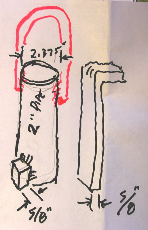

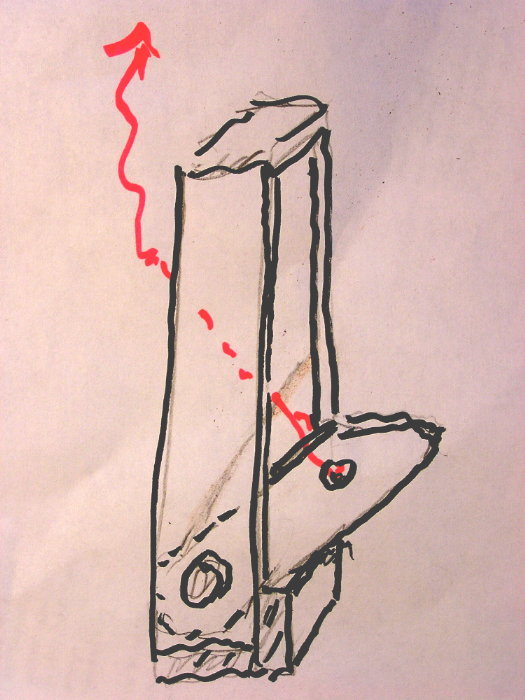

I'd core 3" diameter holes through, maybe two per slab piece. Drop down a "grabber". To release it, pull on the wire.

This pipe may be easier to use and more durable. Make the overall width at lug just short of 3" to fit in the 3" core hole. Drop the "L" piece down opposite the lug. the lifting bail needs to be sufficiently far up so as to not interfere with jamming the "L" piece in. The"L" piece might be more usable if it is 1/2" by 1" strap and still work . Maybe also flatten the lower end of the pipe some, to make clearnce on the opposite side of the lug. Then weld in a plug to keep it from collapsing further under major loads.

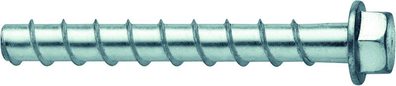

Concrete screw anchors are reusable and only require a match-diameter drill hole and an impact wrench to set and release.
On this 3000lb concrete roof slab we cut and lowered last month, we used 5/8"Ø HILTI EZ anchors and 3/8" thick angle plates.
For your application, with heavier loads, a 2-bolt T-plate/eye-pad at each end, screw anchored and embedded 8" into the panel should work depending on the anchor diameter, and very quick to set and re-use.

HILTI EZ concrete screw anchors:
