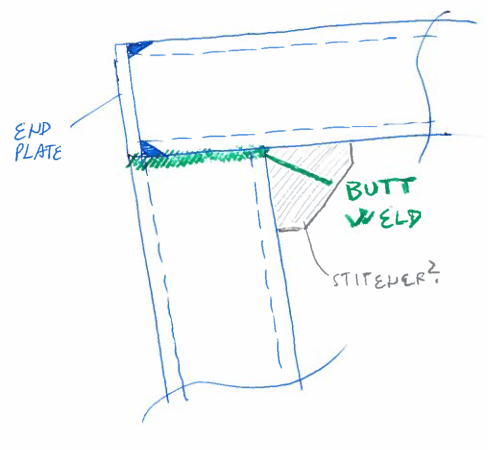

Im designing a steel canopy. All steel elements are hollow profiles (box profiles). All connetions are asummed as pinned. Because of that I braced a construction in roof plane
I have some thoughts about top of column - beam connection. I dont have much experiences with hollow/box profiles but in this case I have to use them.
Im wondering if connection shown in picture is alright in your opinion? Is there a better way?
Bolts are inside of a box profile so the beam would need to rotate quite a bit in order for considerable tension in bolts to develop. Is that right?
Bolts are definitely in tension when winds in blowing upward (resisting uplift) but forces are small.
Shear demands on bolts will be small too.
Is there anything Im missing? im not so confortable with shown connection (but it is aesthetically pleasing) so I want to make it sure before proceeding.

I'd just weld the two profiles together. Those bolts are very difficult to keep in position before tightening.

I usually close off the ends of HSS members....that bm looks like it has torsion loads on it which would require closing off the ends of the bm if one is using the torsional capacity of that member...
RE: steel canopy - beam column connection
If I understand the situation correctly, your canopy joists have vertical support at each end. Hence the nominal loads. As such, I'd be fine with your connection IF it can be physically installed as shown. I'm not sure that it can. And, like SAIL, I prefer to see cap plates on HSS for durability reasons.
As an alternative, you could extend your column cap plates 6" towards the middle of the frame and then fasten to the beam from below with blind bolts (check regional availability). Perhaps the design intent here is a "no bolt" concept. If so, it may be tough to get away from welding.

How is construction going to bolt that in? I'd hate to be trying to tighten the nuts inside of a HSS section.

I was trying to avoid welding since it destroys galvanazing of an element where it is welded (at a joint).
So there needs to be another protection of steel (anti corrosion).
I decided to weld connection (butt weld).
Would you consider that a moment frame (horizontal loads are small), or it will be wise to add a stiffener between column-beam?

Since I ll use welds, I was thinking to make a moment frame - so there is no need for bracing in a roof plane.

Can you make your column width less than the beam width... it will help with welding. Can you eliminate the stiffener... costly to add.

if you use cold bend tubes you are not allowed to weld at the corners
also depending on the wall thickness the corners are rounded ...so this butt weld does not work

My suggestion:
- cut ends of column and beam at 45º and butt weld;
- keep your bracing at roof level;
- design connection as pinned.
For additional info, check CIDECT design guides 1, 3 and 9.

- cut ends of column and beam at 45º and butt weld; - beam and column are not the same dimensions so 45 degree is not an option. Column is 100 x 100 mm and beam in 100 x 150 mm
- keep your bracing at roof level - horizontal forces are very small and whole construction is 2,5 x 3,2 m, i think there is no need for that if beam is welded to a column
- design connection as pinned - i would agree with that if I had larger construction and horizontal forces. If connections are pinned then I really DO need to make horizontal bracing in roof plane, otherwise the construction is labile.
i have seen many canopies similar to this one in my country. They are mostly welded together. Almost none of them has an additional bracing in roof plane.

Well...doing cold bending the corners of the tubes get some material damages ( or whatever) and in this area the ding cannot be used as load carrying connection ...
You can weld ...but this weld cannot be used for structural design

mats12....I have designed many, many canopies with concealed fasteners similar to what you proposed. I would suggest a 4-bolt pattern rather than 2 bolts. Most of mine had embedded columns at the base, so moment carried to foundation to eliminate knee braces or gussets. Have done many different configurations....99% in aluminum....some welding, some bolting. Have ranged in size from simple "lean to" like yours to 100' clear span trusses.
Keep the lateral bracing since you are pinned everywhere.

Well the reason is easy.... because of cold bending the materiel internal structure is somehow changes because of the plastic deformation of the steel ... therefor the steel might not be weldable anymore and thus you cannot use the weld in that zone for design
This is written in Eurocode ...but is also common practice (in Germany)

EN 1993-1-8
Section 4.14 Welding in cold-formed zones

Quote (Link pg 151)
there have been misunderstandings in the interpretation
of Clause 4.14 of EN 1993-1-8 [4] for welding in cold-formed
zones. CIDECT (International Committee for the Development
and Study of Tubular Construction) has therefore
prepared a proposal for corrections to ECCS TC10, for submission
to CEN (European Committee for Standardization).
The text and note in EN 1993-1-8, Clause 4.14 should
be corrected to make clear that, for the conditions specified,
welding in the cold-formed corners and the adjacent
zones is permitted.
Flare bevel groove welds are used all the time between standard structural tubing in the US. Its approval is specifically documented in US design codes. I imagine it is not hard to meet the material and dimensional requirements of EN 1993-1-8 to allow the same.

Attached is Table 3 from EN10219, (Cold formed welded structural hollow sections of non-alloy and fine grain steels - Part 2: Tolerances, dimensions and sectional properties)
where you will find that, if you apply Table 4.2 from EC3-1-8 on cold-formes hollow profiles, you might (depening on the actually used radius) encounter problems starting from a wall thickness of 12mm, which is thicker than the most common used hollow profiles for carports and similar structures.
Edit: Thx MacGruber22 for the article, I have added the file to my library dedicated to this problem. I've had this discussion several times before, but I hadn't seen this document yet. (I hope you get some sleep nowadays!)
