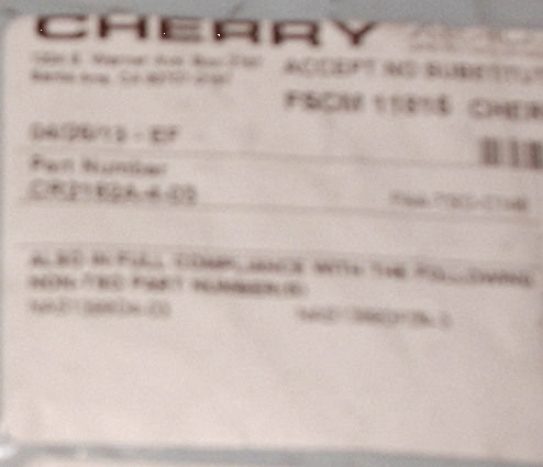

I'm looking at some print outs from CHERRYLOCK and CHERRYMAX but they don't have the information I'm looking for so I thought an Aerospace person smarter than myself (as there are countless)may be of some assistance. Does anyone know the difference between CR2162A-4-02 and CR2162-4-02? I can't find anything telling me what the "a" stands for. Thanks for the help.

from the NAS spec, there is no "A" where you have it. Between dia and grip (ie CR2162-4A2) it means fully serrated stem.

According to the attached [old] Cherry Aerospace Master Cross-Listing, http://files.engineering.com/getfile.aspx?folder=2...
NAS1399DFC()-() = CR2162A-()-()
Per NAS1399...
D = 2017-T4 (UNS A92017) PER QQ-A-430
FC = CHEMICAL FILM ONLY
Regards, Wil Taylor

do you have a 2162A on hand ?
not sure where you are (OEM or mod-shop) but can you follow the trail ...
1) you've got something in your hand that says 2162A ... what references ?
2) is there a drwg that calls 2162A ?
3) is the planning paperwork to show it was done ? (or did they order 2162 ?)
4) is there inspection sign off to confirm it was done ?
RE: I'm looking at some print outs from
I finally got a hold of the Cherry aerospace rep. and he was extremely helpful. The short version is the 2 PN's will get you the same rivet. Here is the Cherry spec. Thank again for all your help. http://www.cherryaerospace.com/doc/stdpage/clock/c....
