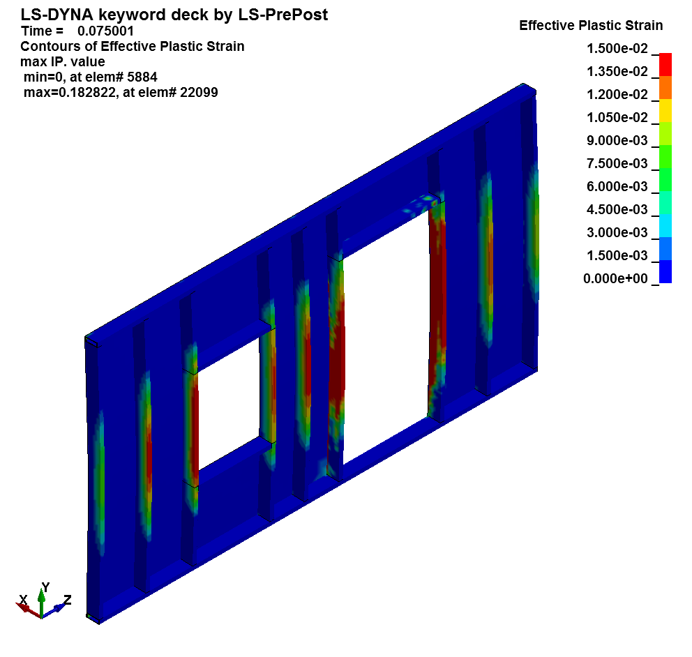

In blast engineering you expect elasto-plastic response, so generate elasto-plastic material curves for steel. Its not about stress so much as it is about for deformation.
Since blast engineering is all about ductility, you want to measure/look at strain and make sure it isn't past the ultimate tensile strain of the material (rupture). In short look at effective plastic strain and compare to maximum allowable plastic strain of material.

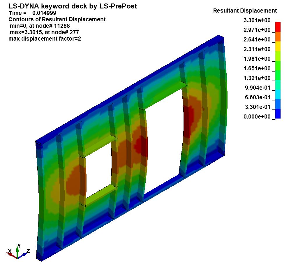

Jeff, once more, thanks for helping me in two parallel threads, which are related to each other! Much appreciated.
Figures you have attached are clearly describing the example.
I have one question
, lets please focus at plastic strain plot of yours. Let's assume 1.5e-02 is the max allowable value given in the code. Plot is a snapshot from the 0.075 time range, as such we know that earlier in time some smaller areas of your structure started to be red of strain values 1.5e-02. The question is how do you know how long / to what extent you may allow red areas to extend over your structure? Perhaps you are measuring also some angular deformation to be less than 2 degrees, or more probably you have some additional information from the code what length of the area with red values (1.5e-02) is allowed?

Glad to help.
In the picture you're refering to I clipped the contour plot of effective plastic strain (EPS) at 1.5E-02 (to get a nice looking plot). So basically I set the contours for the fringe plot. One locally stressed element had an EPS of 0.18, so my cropping of the contour limits makes the figure "look pretty" for the customer. It shows highly stressed regions in the framing members. We really weren't concerned with local yielding at corners of windows and doors. Also I don't remember if this was the final design (satisfactory?)
Regarding your question, your analysis needs to be strain dependent. For your analysis, determine maximum allowable strain and corresponding EPS. This is a function of material properties (Percent Elongation)
Then compare your FEA predicted strains and EPS against the maximum allowable strain.
Duration of the ductile response really isn't a factor as long as you have captured the maximum displacement of the structure (look for a rebound).
You can also check rotation but, I prefer to do this by taking some manual measurements and doing a little trigonometry.

Am I right to say that your EPS value of 1.5E-02 (as per example) was lower than maximum allowable strain?
I thought EPS value was equal to maximum allowable strain, that is why I have asked what area size of the max utilized strain value is within the limits.
RE: Blast Design in FEA - what acceptance criteria
Yes my upper bound fringe plot threshold 1.5E-02 is lower than maximum allowable strain. Depending upon material your maximum allowable strain could be in range of 0.22 to 0.3. EPS is calculated from FEA and needs to be less thn allowable strain
