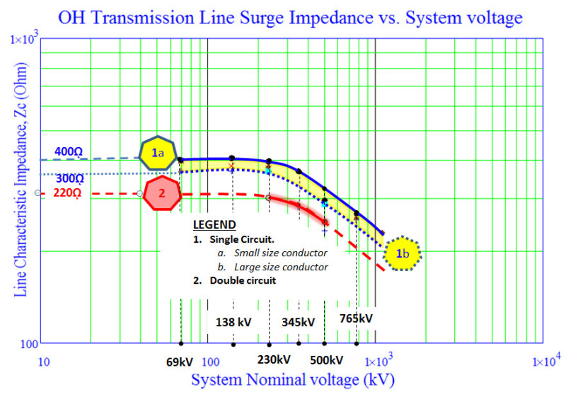

I've been asked to provide characteristic line impedance on GE Line tuner's order form. Any ideas as to how do I go about doing this?

However the line characteristic impedance Z=SQRT[(R+j*w*L)/(G+j*w*C)]
where R,L,C,G=specific resistance, inductance, capacitance and conductance[ohm/km for instance]
These parameters depend on overhead line constructive details-height, distance between conductors, number of circuits on the same tower, conductor material and diameter, earth resistivity and other parameters, and w=2*pi()*freq.

See page 15 of this paper on transmission line characteristic impedance calculations. This is a simplified equation and it works well for this application. In former times, when we made line tuners, this is the formula we gave to customers.

From what I remember, if it's 100% over head, assume about 300 ohms. If it's 100% underground, assume about 30 ohms. If the line is both, good luck.

Below is a simplified practical application how to determine the characteristic impedance of a T. the line.
Hope this help.

The 300 ohms comes from a PLC class I took years ago that was by an ex-GE employee.
Usually the tuner has a range it can be set at, and if it has the correct range, you can start at some point and do a series of reflected power testing at the center of the frequencies you are intending to operate at.
By adjusting the tuning you should find a dip in the reflected power at the sweet spot.
If you calculate the tuning value, you are almost always off by some, and the tech's will be expecting you to be spot on. You will never hear the end of it.

That is correct, the value is just for use as a starting point for the impedance matching transformer. If it can't be tuned with that setting, yo just take it to the next setting up or down depending on tuning results. It's not an exact science for sure. But if you give the factory your best guesstimate of the primary line characteristic impedance, it saves your field techs some time in tuning, as the line tuner is already close to tuned when received.
Most utilities that stock line tuners ask for the IMT to be set at 300 ohms on the primary side.
