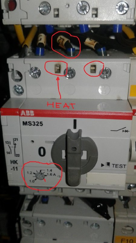

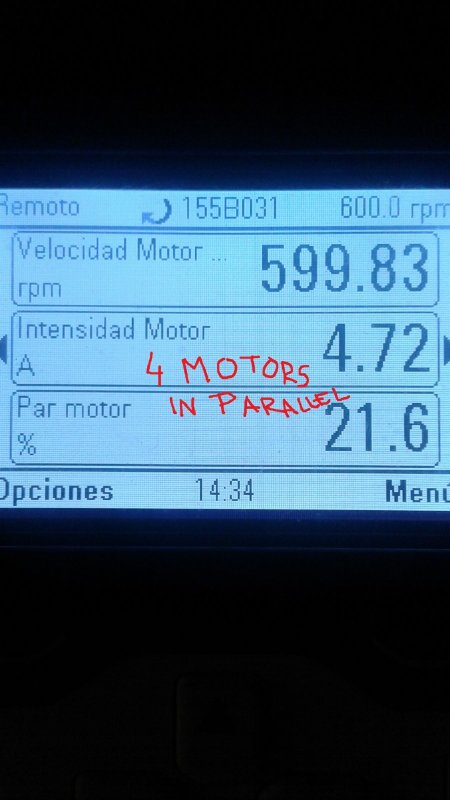

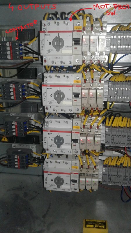

Hello!
we have here one AC drive (ABB ACS800) that has four (4) motor in parallel. The drive is 16amps and the motors are 0,75kw 1amp 690V each.
each output from the drive to the motor has an individual motor protection switch, sized to 1,6Amps
the thing is that te motor protection switch are heating too much today I measure voltage drop and I have 1 volt drop and 1 amp current in each phase.
please see attached pictures.
does anyone have any hint?? is that drive output to four motor in parallel has too much high freq component that causes overheat and problems with bimetallic mechanism??
the cables are 2mm and they are not overheated, also it has a contactor and not overheated, only the motor protection switch!!! I measure ac current rms and I measure 1 amp in each phase for all motors (all motors are the same)
any hint???

The bootlace ferrules show signs of severe overheating: the blue sleeve has turned brown due to heat. This may well be the source of the heat which is affecting the thermal relay.
I suggest re-terminating the cables using a good-quality crimp lug with a flat blade or forked end, such as those made by Cembre or Elpress, and which are typically coloured blue for 2.5mm² cable. For example, http://www.cablejoints.co.uk/sub-product-details/c...

A) 99.9% of motor protection switches like that are not designed to operate at anything other than 50/60Hz. The bi-metal heating elements are not calibrated for variable frequency use.
B) Without even looking for and reading the manual for them, I'm going to go out on a limb and say that the installer (don't know if it is you or if you inherited this) did not follow the manufacturer's instructions regarding spacing and "heat stacking"; the problem of heat from one unit rising into the next, then the next, etc.. Most devices like that require at least 1" (25mm) of spacing, and even then if it is being used on a VFD circuit, I would not push the envelope, give any current carrying components plenty of room to "breathe". So so many times I see people try to cram way too much electrical equipment into spaces not suited for them, then complain about parts over heating.
Electricity flow = heat...

Good point Jeff! Those top contactors are going to be basking in all the heat piled up at the top of the enclosure too.

I'm with Scotty. Check the lugs and check that the screws are tight enough. If there is serious heat damage from poor connection the devices may not be repairable.
If heat stacking is an issue the upper devices may be more prone to tripping.

Thank you very much for your answers.
this MCC came as shown from factory but even though distance is short there must be something else.
I measured with an AC clamp true rms, 0,9-1,1 amps and I regard this as very low current to overheat the motor protection switches. The heat is true, you can't hold your finger on it. Someone changed one to 4amps and the heat is less, but still some.
the drive has no output filter, this I regard as a problem. Can the heating element inside the mot. prot. switch be affected by other frequencies than 50/60hz that I cannot measure with a true rms clamp?

Make sure they don't crowd their next enclosure so much. Providing some air flow wouldn't hurt either.
