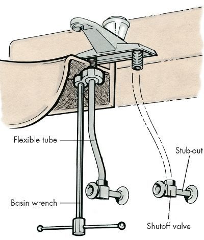

This type of faucet extension is rarely used in the United States. Possibly used on extremely expensive imported faucet models.
The US practice is to use stub outs:
https://www.youtube.com/watch?v=iBL_oYem3q0
