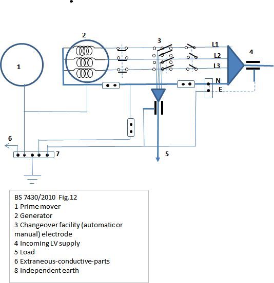

RE: Pump station grounding system
In my opinion, you can follow the BS7430/2010 :
ch.7.2.5 Generators providing a changeover supply
Figure 12 Single low voltage standby generator (without paralleling facility)
NOTE Changeover switch could be 3-pole with linked neutral.
and ch. 7.2.7 Generator operating in parallel with the electricity supply
Problems of neutral/earth circulating currents arise when a generating set is operated in parallel with an incoming supply; where the magnitude of the circulating currents would be excessive or if the generating set is also required to operate in the changeover mode, the options described in 7.2.6 should be followed.
