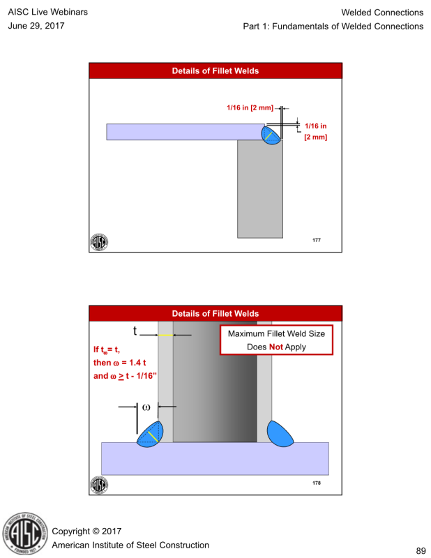

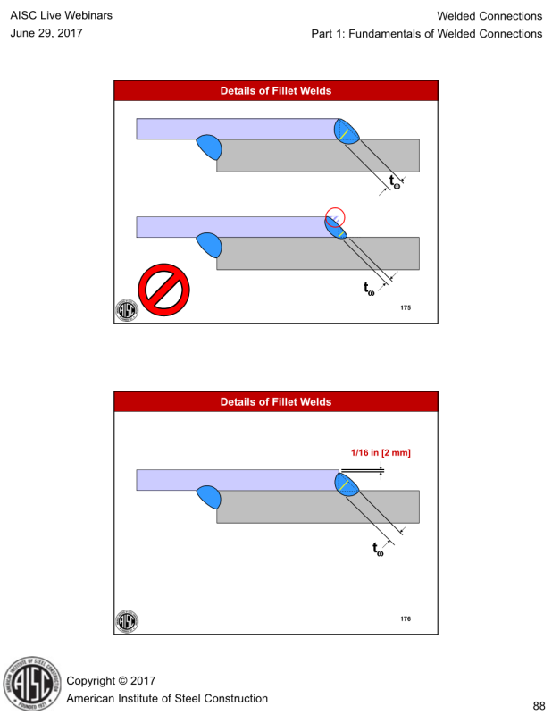

I am 'attending' the AISC's (US steel organisation not ASI) 3-part webinar entitled: WELDED CONNECTIONS - A THREE-PART WEBINAR SERIES Link and it is presented by Duane Miller (same author referenced in your web 'welding myths' article).
Here is what AWS states for MAX fillet weld size:
Effect of edges corner 'melted' away resulting in less than tw which is the reason why AWS has the 1/16" reduction:
And MAX fillet weld sizes do not apply to surfaces, only edges:

I have not practiced in AU for several decades - are fillet welds specified by weld 'leg size' or 'throat size'? I think it is 'throat'.
Quote (steveh49)
One effect of the AS 5100 rule is that the full capacity hollow sections cannot be achieved with fillet welds.

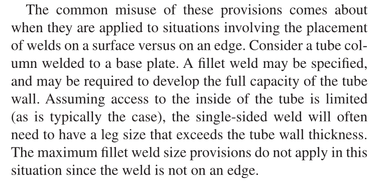

You mean in a HS to base plate connection? I know this ref is NOT AS 5100, but from the US AISC's publication entitled "Design Guide 21: Welded Connections--A Primer for Engineers" Link it states this, re hollow sections:
RE: AS 5100.6 maximum fillet weld vs AS 4100
Hi Ingenuity, it's leg length also in Australia. Your extract is exactly the issue and it also applies to other situations such as web-to-chord connections in trusses.
