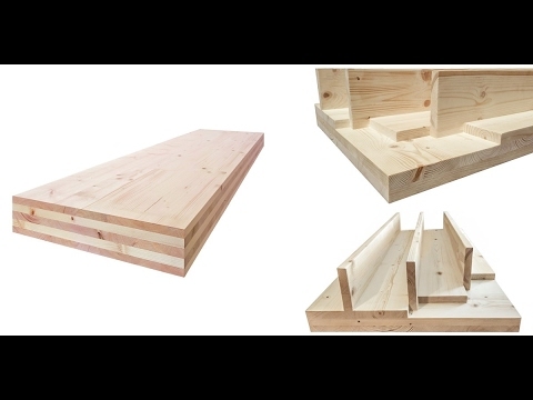

Thanks for taking the time to post such a detailed response molibden. It's a great help. Sounds like non-comp is probably the way to go. I'd never even heard of ribbed CLT prior to this post. Bloody cool.

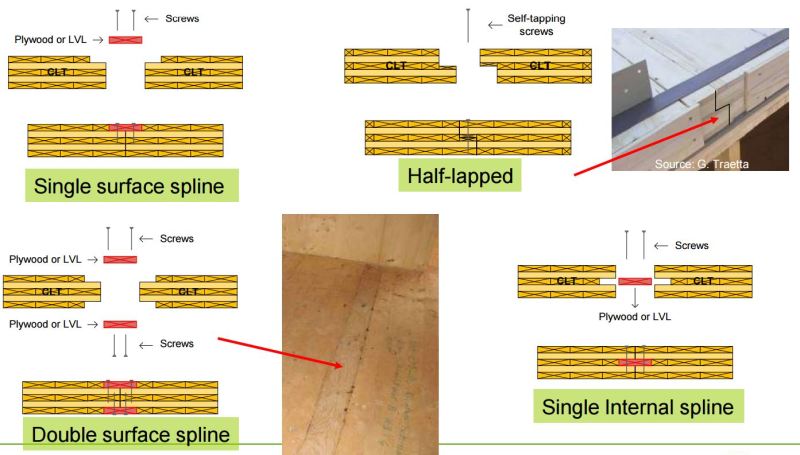

It will indeed have glued and screwed plywood. I've been getting mixed messages as to whether or not the plywood is necessary for the thing to be useful as a diaphragm. Anybody have any insight to share on that front? That seems to be the common approach but, with some interconnection between GLT panels, it's hard to imagine that not being the stiffer path for any applied lateral loads.

You can do a ribbed CLT slab also on-site with gluing and screwing timber glulams to bottom or top of the slab. If there is glue and under right conditions one can presume rigid connection, if not then you rely on screws (perpendicular or under inclination) and consider shear slip with connection stiffness.
For CLT diaphragm you can make all joints work. I like half-lapped joints because it's simple and more rigid vertical direction than with plywood. Just make sure you have sufficient distance from slab edge to screws and sufficient number of screws. Most common we put self-tapping screws diameter 8mm @ 250-300mm.
RE: Concrete Topping on GLT Floor for Vibration - Composite Action
Beauty. Whenever someone goes to the trouble of posting graphics for me, I just assume an incurred personal debt of 0.25 billable hours min.
