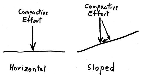

Quote:
Suppose you have a 6:1 slope, and you place and compact a uniform lift on the slope, with the same 6:1 slope. Why is that different than placing a uniform lift of the same thickness on horizontal ground?
IMHO, a one word cause... Gravity.
Any real-world compactive equipment either uses or is affected by gravity.
On a horizontal surface all compactive energy is used for it's intended purpose - soil compaction.
On a sloped surface some of the compactive energy is directed parallel to the sloped surface. Remaining energy that is perpendicular to sloped surface is reduced a little, but that is usually minor compared to the disruptive "sideways" component.

RE: Compaction of fills on a slope
So the issue is that it's harder to achieve the targetted compaction?
Supposing that you actually achieve the SPMDD target, there should be no issue then?
I've also heard the argument that the requirement is based on nuclear densometers not working on a slope, based on an older version of the ASTM standard which implies this is the case.
Agree with SRE; however, when you achieve compaction, you're done. It's less efficient for compaction purposes, but if you achieve the result, no issue other than extra time.
