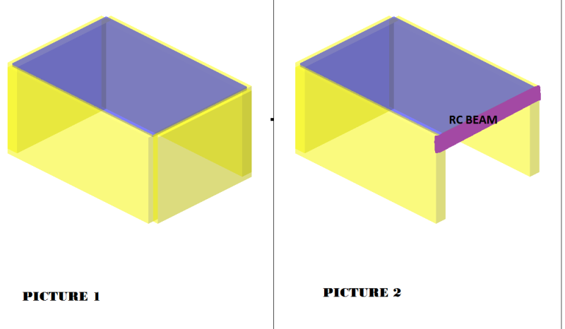

hi, this is really not my area but i want to know about this one...
PICTURE 1 - slab is supported on 4 masonry walls.
PICTURE 2 - we remove one wall under existing slab and we made RC beam instead.
my question - do bending moments in existing slab change because we remove a bearing wall even tho we replaced it with a RC beam?
are bending moments of slab depending on a stiffness of a RC beam?
Since masonry wall is far more stiff in vertical direction than a RC beam (deflection) I think there might be larger bending moments (tension in lower zone of a slab) because of this? Or am I wrong?

RE: change of bending moments in RC slab
If the beam is infinitely rigid, moments in the slab will change very little.
You are probably somewhere in between these two. So yes, it does depend on the rigidity of the beam...and also to some extent the relative beam-slab values of rigidity.
