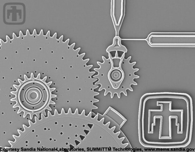

RE: VERY small piping question
Have you considered a valve like the purported vasectomy valves.
It should be possible to fabricate a valve using nano technology that is remotely adjustable. The valve would need no batteries - only a microscopic antenna.
