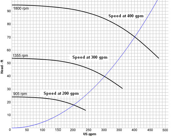

as per the pump laws ( or fan laws) the volumetric flow varies with the rpm while the develop head varies with the RPM^2. If the required head varies then it would be necessary to run thepump at the RPM needed for the max developed head and then throttle the discharge pressure as the need for a lower flow is met.
RE: constant flow variable speed pump for heat exchanger
I disagree. what happens is that you will move further along the curve for the same flow but lower head. You need to remember here that the OPs system curve keeps changing as the tanks fill and empty.
Hence the speed reduction is proportional to SQR of flow, but a bit more speed is need to match up the flow.
Speed variation on a VFD is similar to changing impellor size.
Hence in the picture below, which is a little extreme, if you want to maintain say 200 GPM, then you can do that if your system curve changes ( which it does for the OP) so that at say 200 GPM his head across the pump could be 18 ft to 90 ft corresponding to 900rpm to 1800 rpm.
I think that range is a bit large myself so I would be more inclined to go for 300 gpm at min diff head of 40ft vs max diff head of 90 ft
VFDs run on flow control all the time to maintain a set flow.
