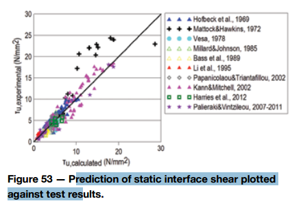

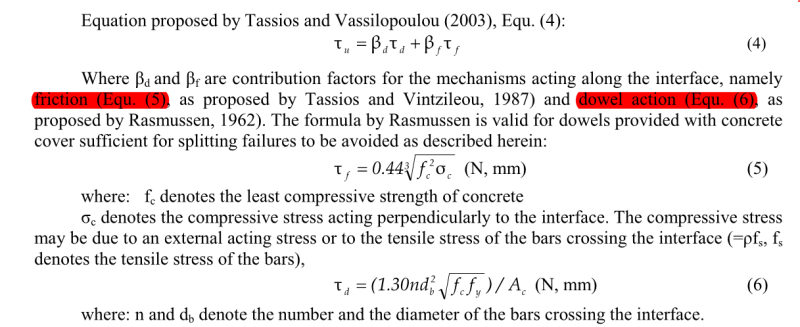

Been digging into this a bit. In their 2016 post installed rebar design guide, Hilti covers dowels for shear friction based on a paper by Palieraki (attached). It's a hybrid dowel/shear friction method that seems to yield rather astonishing accuracy with respect to test results. The example that is cover in the design guide uses #5 bars embedded 7.5 in for a cyclic shear example. For monotonic shear, they don't specify a lower limit but imply values of 8db or less. There's no mention of developing for Fy etc. I'm not sure how "street legal" it all is for code compliant use in the the US but this clearly seems to be the way of the future for such applications.

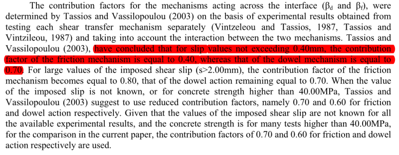

Palieraki paper
I have been digging into this a bunch of papers in the past 24 hours and the Palieraki et. al paper was referenced in a few documents I researched, including the Hilti Post-Installed Reinforcing Bar Guide you cited. The paper I have appears to be a bit different to your paper. The copy I have is entitled "SHEAR TRANSFER ALONG INTERFACES: CONSTITUTIVE LAWS. Dated 2014. What paper is your graphic post from?
Interesting that the researchers split up the capacity into friction and dowel components, rather than 'baking it into the cake' (as you would say!):
Also, the contributions factor for low-levels of slip lean towards dowel action by near 2 times:

Quote (KootK)
...and with a significant database over a significant duration of time:
Quote (PALIERAKI et.al. "SHEAR TRANSFER ALONG INTERFACES: CONSTITUTIVE LAWS")
In total, results from 18 papers, produced between 1960 and 2012 have been collected. Results from almost 580 tests regarding interfaces with different dimensions and geometry, covering a wide range of material properties are included in the evaluated research works.

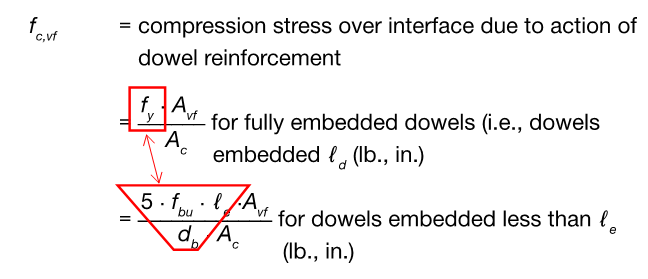

Using the interface shear design method proposed by Palieraki et.al. consisting of the summation of friction and dowel action effects, based upon HILTI's Post-Installed Reinforcing Bar Guide 2016 and assuming UNcracked concrete, and #5 dowels with ONLY 5" (= 8 db) embedment, I calc an effective capacity of 13.9 kips, assuming a 6" x 6" grid spacing of dowels:
ACI 318 shear-friction gives me:
ΦVn = 0.75 * 1.0 * 0.31 in2 * 60 ksi = 13.9 kips! Co-incidently the same, but I have only embeded the dowels 5" into the substrate!!!
Also the equation for fc,vf needs to be limited so that [5 fbu le / db] term does NOT exceed fsy, in my opinion:
