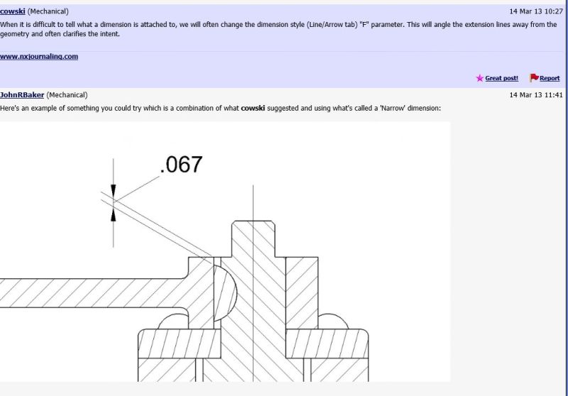

Can I still create a narrow dimension with NX 11?
I saw this post but can't find the settings to create a narrow dimension. Can it still be done with NX11?

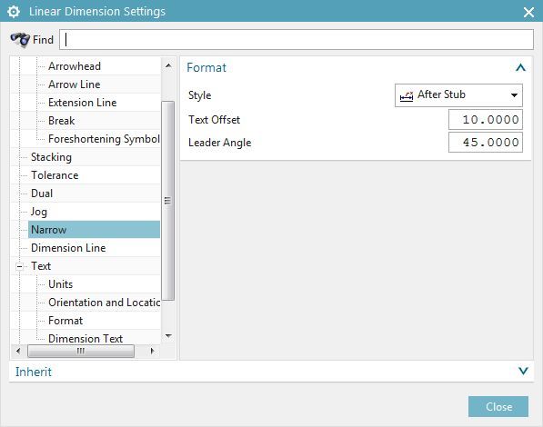

RE: Can I still create a narrow dimension with NX 11?
Dimension settings -> narrow -> pick your desired options.
Thanks guys.. I found the Narrow option but still can find how to adjust the extension line angle like shown in the pic above.
CRAP! I found it.. The angle wasn't showing up with a perpendicular dimension. Seem like it's only available with Horiz or Vert dimensions. I'd like to use it on a point to point.
