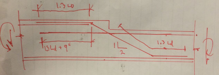

dear engineers,
i inquire about the details shown in the attached file
i want to make a detail for continuous slab with cantilever without making any torsion effect on the supporting beam as the designer did not provide this beam with closed stirrups or side bars for torsion
i provide 3 details in the file
detail 1 : recommended by most of my colleagues as the detailed rft extend from the slab to cantilever and the cantilever slab rft extended to the slab without any rft extension into beam body or depth
details 2 and 3
i do not know what is wrong with them , but all of my collegues do not recommend it as slab or cantilever slab rft extend into the beam body which can change the statical system shown in file to another system from the intended one like the beam carry torsion moment which is not designed to resist
i say however the rft extend into beam body but the other slab rft extend also in the beam with Ld which will receive the tension force from beam to the other slab
please give me your opinion
regards
m.samir

I'd probably run with detail 2, but would not connect the bot rfg in the cantilever to the top reinf and would extend it into the slab on the right if you need it for compression steel (deflection or whatever), else, I would omit it.
Dik

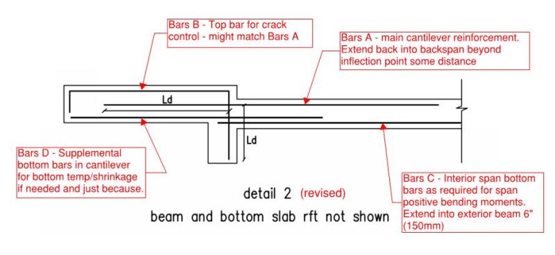

RE: detailing inquiry
We addressed a nearly identical problem recently here: Link. There's good, relevant information in that thread and my suggestion from it is shown below. The bottom steel isn't terribly important here. just lap it at the offset as you've shown in your detail #2.
JAE... pretty much same wavelength... good comment on Detail 3.
