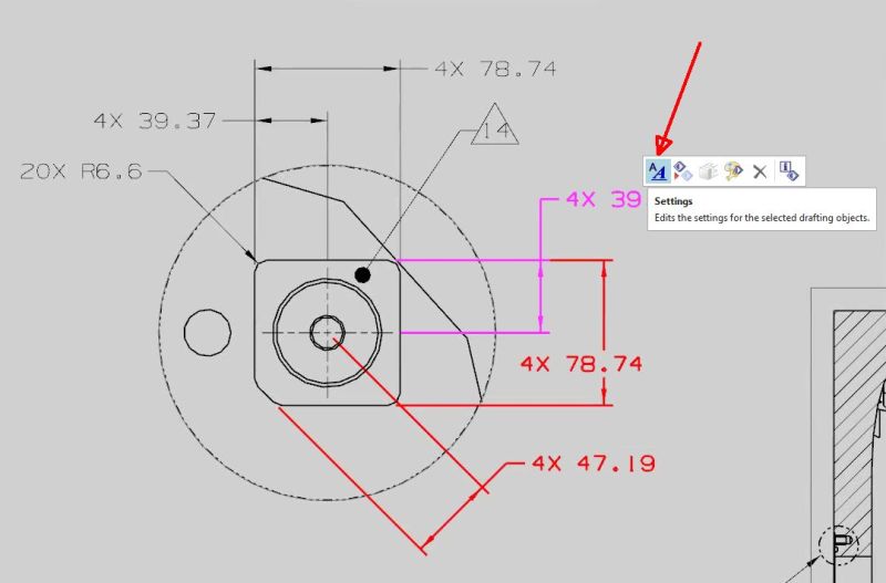

I'm running NX11 from what they call a blade server. When I select the settings button to modify dimensions or views I get at least a minute delay until the window pops up. Sometime after the first time adjusting a jog on an ordinate dim it will work as expected. I'm the only one experiencing this and so far our Tech Expert has not been able to help me.
Any ideas?

I would look in the syslog to see what is being loaded when you select the Settings button.

Also try clearing your Dialog Memory.

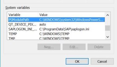

Many years ago I encountered the same problem in drafting and it was a license error
Have a look at your SPLM_LICENSE_SERVER variable
Is it equal to one server or many server separated by "," or ";" ?
Check the difference with your colleague

Just tried deleting DialogMemory and restarting NX. No change.. My License server is set as shown below and so my neighbor's who does not experience the issue.
SPLM_LICENSE_SERVER 28000@flexserverTX1,28000@flexserverTX2,28000@flexserverTX3
Not sure what I'm looking for in my log after I Select Settings.

&MACRO MENU, 0, UG_HELP_SYSTEM_LOG UG_GATEWAY_MAIN_MENUBAR <RibbonTopBar->MenuBar->UG_HELP> ## !

DidierPSICAD:
Not yet. I don't have permission to change the environment variable on the server. I hope it works. I'll let you know.
RE: Over 1 min delay after selecting settings for dimensions
Hi Barnon,
This variable is on your PC and not in the server
Regards
Didier Psaltopoulos
http://www.psi-cad.fr
We run a off of what they call a blade server accessed thru Citrix. Kinda like a VPN I guess. That variable doesn't exist on my laptop.
Changing the , to a ; didn't work... I was hopeful.
Hi Barnon,
First, You say that this variable doesn't exist then you say it didn't work ???
Regards
Didier Psaltopoulos
It exists on the Blade server not my computer. I had to get special access before I could modify it.
