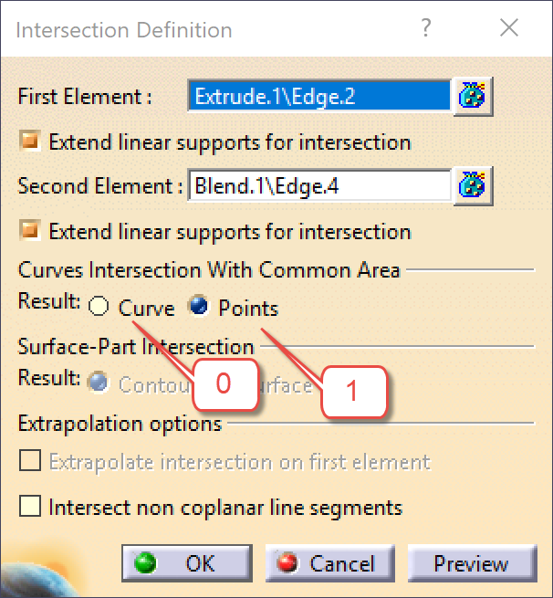

3. What does the PointType property control and what other options are there? the catia documentation only gives me the following:
Property PointType( ) As long
Returns or sets the PointType flag for intersect.

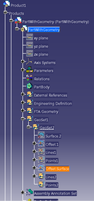

It would be easier to help if you said what you want the macro to do and if you had a picture of your specification tree so we can see the structure. Will the tree look the same all the time?

What Im trying here is only part of a slightly bigger project. Ultimately I want to copy and paste a selected part multiple times and constrain it to a user selected set of geometry (note im working in a product). So the idea is that the user selects a bunch of lines (using SelectElement3 method) and a (curved) mating surface. The macro will then create an intersection with the line and surface, the resulting point will be used to constrain the copied part as well as the original line.
Initially my idea was to ask the user to select lines as well as points and then match these, but I was having difficulty matching the line to the correct point, the result was that the copied parts were flying around in space. The other issue I ran into here is the same as point 2 where I couldn't figure out how to properly reference the line, e.g. There are two lines named Line.1 in my part, but these are in different geo. sets. I think CATIA has another internal naming of features besides the one displayed in the tree?? it looked like the macro was selecting the first line made...
My intention is to eventually set-up a loop and then go through all the lines selected by the user, I was just trying to get the intersection part right first.
My tree (for this initial test) looks something like this:
There is another part still in the product that cant be seen on the screenshot, the line I want to refer to is in the set Lines2, whereas another line with the same name exists in Lines1. (although I would also use the tool for the lines in 'Lines1')
I want to be able to use the tool for different projects and allow the user to select the lines he/she wants therefore there is no guarantee the tree will look the same everytime

.PointType is used to get/set the following option:
sorry for big picture i just realized it is because I have 4K screen and scale 200%. I'll try to reduce size next time :)
