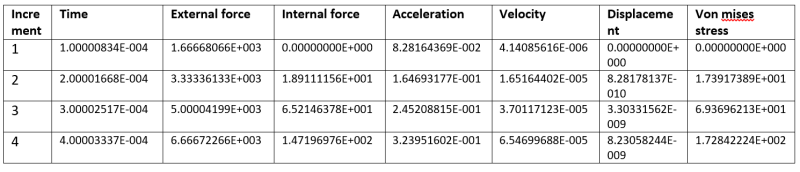

Does anyone know how Δt in Abaqus explicit is calculated?. I tried Δt = l/c but that is stable increment. I would like to know how velocity is calculated in Abaqus explicit so I need Δt values . I even added screenshot of the formula. If it is based on natural frequency then delta t values does not vary much but it does vary alot. Please someone help me with this.

Please read the short explanation of how I got the delta t(i+1) and delta t(i) values by using increment 1 and increment 2 values from above table:
Increment 1:
acceleration = 0.0828164369 m/sec^2, velocity = 0.00000414085616 m/sec, displacement = 0 (dont know why its zero)
according to Abaqus Theory guide 2.4.5 (http://129.97.46.200:2080/v6.14/books/stm/default....)
velocity(i+0.5) = velocity(i-0.5) + [((delta t(i+1) + delta t(i))/2) * acceleration(i)]
so substituting increment 1 value gives
0.00000414085616 = 0 +[((delta t(i+1) + delta t(i))/2) * 0.0828164369]
(delta t(i+1) + delta t(i))/2) = 0.0000500004
Increment 2:
acceleration = 0.164693177 m/sec^2, velocity = 0.0000165164402 m/sec, displacement = 8.28178137*E-10
by using above method
(delta t(i+1) + delta t(i))/2) = 0.0000751433
but in this we have displacement value which makes it possible to get delta t(i+1) value from following equation
displacement(i+1) = displacement(i) + delta t(i+1)* velocity(i+0.5)
8.28178137*E-10 = 0 + delta t(i+1) * 0.0000165164402
delta t (i+1) = 0.0000501427
so delta t (i) = 0.0001001439
I know its amateur method of finding it but I did it to make sure what could be the values because Explicit does not do iterations so correct me if I am wrong in doing above calculation.

Thanks for the quick response. I already have tried using characterstic length (Le) to dilational speed wave ratio (cd) but the numbers are far from delta values.
Please see the following delta t values using various formulas:
1) delta t = L/C where L is element length which 10 metres in my case and C = sqrt(E/density) for beam which gives 0.00195789 for every increment as displacement is very small as you can see from table
2) delta t = L/c , where c equals sqrt((lambda+2*mu)/density) , which gives 0.0016084819
If there is anyother formula for dilational wave speed please let me know
omega = 0.2 * (sqrt(g/deflection)) , 0.2 used for cantilever instead of 1.732 which gives 0, 0.00009187, 0.0001835332, 0.0002897043 which has a range almost close to delta t values at the start but not as increment proceeds.
