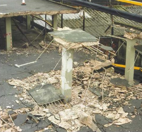

3) There are two major non-column problems with the strategy of ignoring the column moments in a flat slab. Firstly, you may see a lot of undesirable cracking in the slab over the columns if you're designing for moments a lot smaller than the calculated elastic moments. Secondly, if you underestimate the demand for punching shear moment capacity at the slab/column joint, you could end up with a brittle, catastrophic punching shear failure causing your slabs to pancake. See the sketch below intended to frighten you. Although that one's surely got more to do with axial load overstress rather than moments.

Quote (KootK)
...coupled with the fact that is was of lift slab construction, with long-term history of deterioration and attempted but failed repairs over several column/slab areas. Pipers Row Car Park in the UK. Collapsed in March 1997.
RE: Flat Slab design-column moments
Going for dramatic effect, not historical accuracy.

Quote (KootK)
I think it worked. These types of photos always give me the cold-sweat thoughts of "damn, did I check x, y and z".
