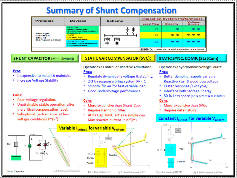

Do FACTS devices not worsen the power factor of the power system while improving the voltage stability? No
How is power factor kept in a decent range while using the FACTS devices? See the info below

You add capacitive KVARs to the system to raise the voltage. This first cancels the affect of any inductive KVARs in the line.
One problem with inductive KVARs is a reactive voltage drop. With capacitive KVARS, you have a reactive voltage rise.
