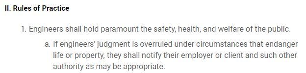

Here's a snippet of the NSPE code of ethics section that applies:

In a private residence the issue of "public safety" is is limited.
RE: Private residential inspection - When to notify building official of unsafe structure
I consider the homeowner, his friends, family, tenants, neighbors, buyers, delivery people, etc. to all be members of the public. Maybe not quite like a public school, but I fail to see much limitation.
Yes, a house is just as subject to the need for Public safety as any other building.
You have an obligation to notify the building official in the event the owner does not immediately correct the issue. You have an ethical obligation to notify the owner that you are going to notify the building official. If the owner asks you to not notify the building official and states that he is going to rectify the condition, tell him that you have an obligation to check to see that it is done. Tell him you will give him a reasonable timeframe to correct the issue (30 days?) and tell him that if it is not done in the stated timeframe you have a legal obligation to notify the building official.
Yes...a single family residence has the same "public" status as any building. The owner will likely eventually sell it to someone "in the public realm".
Sounds like a great way to make yourself look foolish in most cases. What do you expect the building department to do, order it repaired or demolished? From the most rural areas to our densest inner cities we are quite literally surrounding by structures with major safety issues. Per the VA, a staircase without a railing is unsafe. Per my relatives, hay loft floors are safe until someone falls through. Sure, if an occupied rental or commercial building is about to collapse and you don't believe the owner is taking the repair seriously then by all means report them. OTOH, if a client wants advice about an unoccupied century-old farmhouse then common sense should prevail.
CWB1.....if an engineer perceives a condition to be unsafe, they have an ethical duty to report it according to NSPE. So yes, that is exactly the expectation of the building department....order it repaired or demolished. I would much rather look foolish by reporting an issue that turned out to be non-safety related than not reporting the issue and someone being hurt or killed. I don't think we are surrounded by "major safety issues", I think we may be surrounded by non code compliant issues (which may or may not be a safety issue). No engineer wants to be the handrail police, but we all should be vigilant of potential safety issues.
