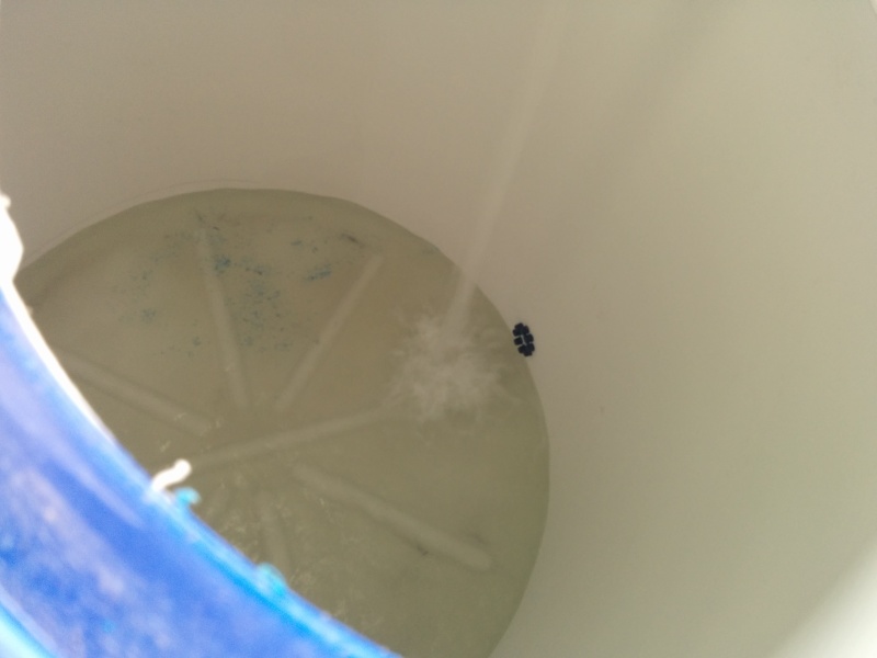

Hello again! After much datasheet reading I think I am somewhat settled on "Flowline EchoPod" (5.5m range, ultrasonic, by automation direct). It has a feature where it can do continuous (4..20mA) or act as a switch with several low voltage relays. I will mount it in a bulkhead fitting on top of the tank.
Are there any gotcha's that I should be aware of?
PS. Here is a picture of my tank. Actually, there are two - a small one 15m3 and a big one 30m3. Both hold water at different stages of purification.

A bit of an update :)
In the past few days I've had the first tries at the sensors. Easy to configure with their program (and usb stick). However, you have to disconnect the sensor first, ie no "live" debugging. Which means for any changes you have to climb on top of the tank and disconnect/reconnect all the little wires from the junction box... with a laptop in tow.
Anyhow, what I am finding is this: the sensor works great "at rest", ie when there's not water being added into the tank. (See pic). But when water is being added it seems the sensor loses the signal. Not sure whether it is because of the waves (maybe about an in inch or two in amplitude, not violent), or the column of incoming water (see pic).
I have the sensor mounted at 90 degrees (around the circumference of the tank) to the incoming nozzle. Using bulkhead fitting, flat surface.
Any help?

That's annoying!
Get a piece of cheap PVC to make an ultrasonic well. The water inside will, of course, match what's outside it provide a quiet smooth surface.
Other thoughts are that ultrasonic is sound. That huge hard-walled tank with water falling a mile down into it will be filled with ultrasonic sound including the reflected sound from the sensor. I think that's causing lots of un-reasonable returns to the receiver causing it to blank. Can the transmitted sound level be turned down causing less reflected power? Can the falling water be directed into a standpipe preventing any ripples and its noise?

Hi guys, sorry, been neglecting this post to work on pump controls, but actually I have some updates for this. But first, the questions.
Indeed, I am using an ultrasonic. Flowline dt-34. Is it considered good quality? Seems well made. It has some programmable relays which I utilize for low and high switches. (It also outputs 4..20mA on its power supply line, which is useful for debugging). But I do need the relays, as I am going PLC-free, heh.
Update. It now seems that the problem is electrical in nature. When drawing down the tanks with a pump (surface level completely calm, no falling water), the phantom relay activation/sticking still occurs. Sometimes the all relays of the sensor will suddely activate and then go off soon after. This is more rare, usually the relays just keep their state even if the switch condition has changed. The correct state is assumed immediately after all the pumps are stopped. This does not happen if draining the tank by gravity. Switching occurs at prescribed levels as would be expected. The 4..20 mA output does not die (eg go to some default value) during these phoenomena, instead it still shows a "reasonable" value and keeps changing. Seems like the problem is caused by having the signal cables near the power cables, yes? However, I am using shielded cable, 220 VAC signal level and have grounded the cable only on one end. The instrument ground and motor ground are tied together at the panel unfortunately.

I couldn't find DT-34 on the Flowline site, I assume its the DL-34 you have
Provided the cable is shielded properly you should be able to run the cable right beside the motor cable.
However are you running the AC motor controls in the same cable to the internal relays, that could be a problem
Perhaps try using a separate DC relay located back at the motor control point to control the motor in other words completely isolate the On/Off signal between the DL-34 and the motor.
I wouldn't go as far as to call the Flowline a high quality Ultrasonic but you may be able to get it working reliably.
If you think there is interference from splashing perhaps try to guide the falling water to run down the side of the tank or just operate over a shorter range at the top of tank.

Hi Roy, sorry for the slow reply. There was a break-in at our site mid this week. Thieves made off with a number of large power breakers and some smaller stuff from the outside control panels. So I've kind of been preoccupied with that :(
Anyways, the internal sensor relays are driving a coil of a panel-side relay (using 220 VAC as control signal). This coil, in turn, opens/closes contacts in the motor control circuit. I think this is the same as what you suggested.
Would using 24VDC as control signal instead of 220 VAC make any difference? Do you think common ground between motors and instruments may have anything to do with this?

I don't think a common ground would be the problem but I think you are saying the 220 VAC control signal is switched inside the transmitter, if that's the case I can see a problem.
Yes a 24 Volt coil will make a big difference, you should not have 220 VAC anywhere near the transmitter or cable to it, only Low Voltage DC, There is too much coupling between the AC and DC

Hi guys, a little bit of an update.
Finally finished changing the ultrasonic sensor relays to use 24 VDC (from 220 VAC previously). Unfortunately, the phantom behavior still remains... There are a few other electrical gremelins too, which may be related.
