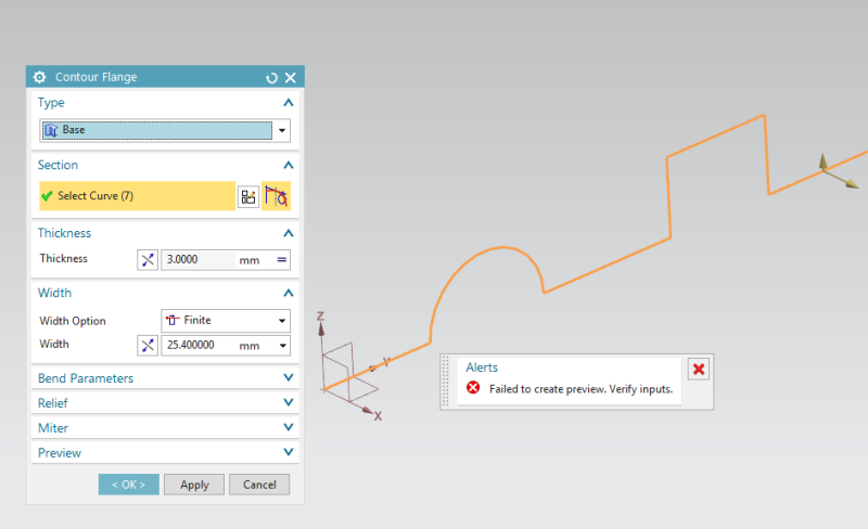

I would like to know if there is anyway of doing this with a sheetmetal feature.

I have to say I´m a novice at sheetmetal.

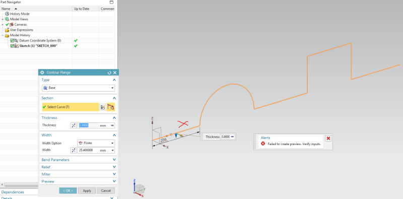

My first attempt was Contour flange but an error message was displayed:

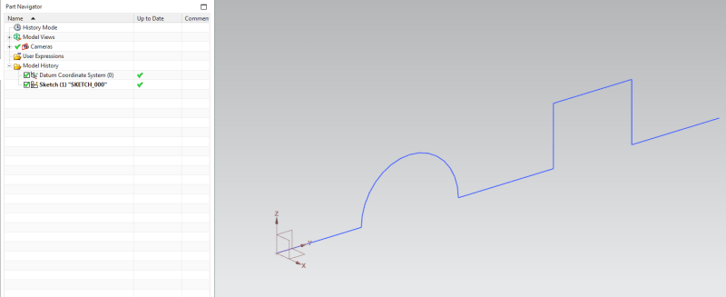

1Step:

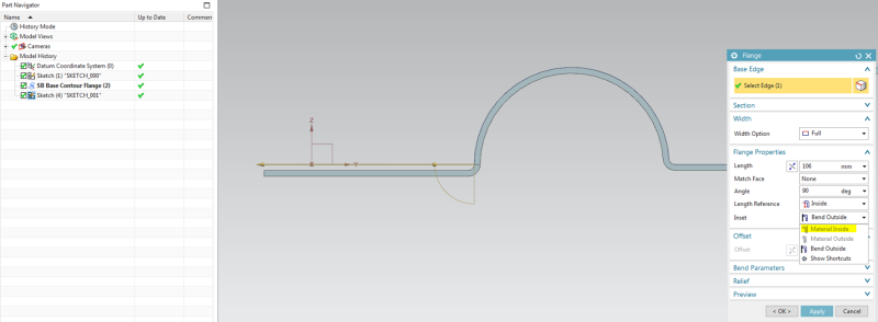

2step:
3step:
4step: (make a contour flange without the last curve and then make a normal flange)
But I can´t set inside material!
workaround: (make fillets in the sketch)

RE: How to do this with sheetmetal feature
Yes you right
it seems like a buggy
I tried it and it allow me to finishe half
of the profile only.
That's a pretty ridiculous bug!
( I tried it in NX8.5 and, yes, it's a bug.)
Will you report it to GTAC ?
