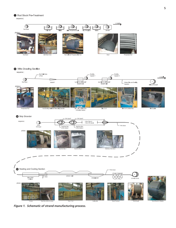

The US-based TRANSPORTATION RESEARCH BOARD authored a document in 2008 entitled "Acceptance Tests for Surface Characteristics of Steel Strands in Prestressed Concrete". It is very detailed on matters related to strand surface, and may address part of your problem. Free downloaded copy is available here: Link
Part copy of paragraph from page 7 of the above document:
I would be placing the onus on the manufacturer to directly address the issue - bypass the supplier and get answers from the manufacturer.
