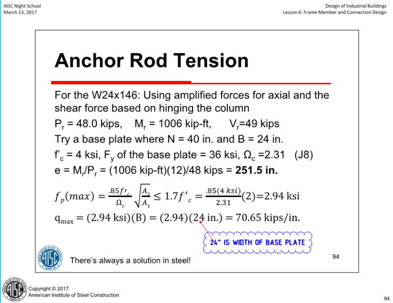

I have a 3 story OCBF building in seismic design category D. I was looking into ASIC-341, the code says the brace connections need to be designed for over-strength combination. Does that mean the anchors and base plate also needs to be designed for over-strength combination? Is there a way out of this? Does AISC address this.

I just finished the AISC Night School 13 on Design of Industrial Builidngs, and on Lesson 6 the presenter (Jules van De Pas) went through calculations that INCLUDED the overstrength factor for both the base plate and anchor rod design. It was a OCB frame in SDC D.
I will find the relevant pages and post it ASAP.

Two slides from the presentation with regards to column base plates/anchor rods:
