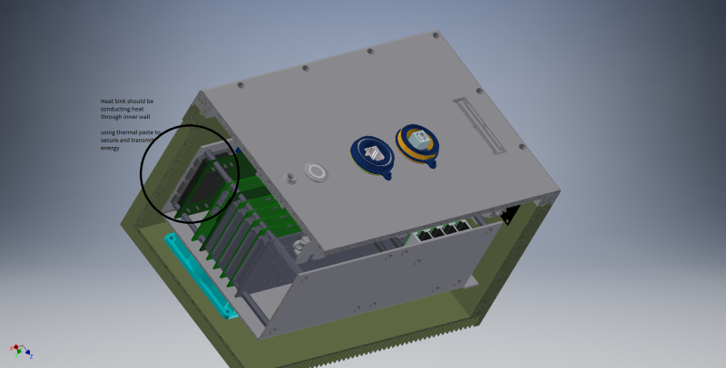

I am designing IP65 Electrical Enclosure with 80w internal Heat load. It is small and dont have a lot of room for vents, the only IP65 vents I see are made for large off the shelf enclosures.
I have 2 questions:
1. What is the external solar load I need to consider?
Based on charts below, aluminum enclosure, clear anodized, with 20deg delta T between ambient and internal, should not have a solar heat gain. Correct?
2. Calculate Internal Air temp with fan, inside of sealed enclosure?
What is the best way to calculate cooling effects in a sealed, small enclosure(12in x 8in x 6in )
Most of the cooling effect comes from the temperature differential but I want to quantify the air movement effects and if increasing the fan flow rate would improve cooling 20-30%
See my Calculation Page as an attached file, http://files.engineering.com/getfile.aspx?folder=0... it is based on surface area of the enclosure, plus the additional area of the fins that are cut into the side.
See also, the box geometry here, http://files.engineering.com/getfile.aspx?folder=7...
Current Calc Sheet that I have going
Chart for Solar Heat Gain
Thanks for all of the help!

I can't speak to the solar loading but I did run some quick calculations for your deltaT.
An enclosure of 12" x 8" x 6" (LxWxH) that dissipates 80W using only natural convection will have an outer surface temperature that is about 53C above ambient. If you had enough fins on the sides to approximately double the total surface area of the enclosure you still have an outer surface temperature about 40C above ambient.
I can only get the outer surface temperature for this quick 1st order calculation but your internal air temp will be higher and any component temps will be higher still(possibly much higher).
Any increase in deltaT due to solar loading will be in addition to the numbers I gave.

It's a very tiny box to be dumping so much power. Assuming that it's coming from a 12x8 board, even forced convection on that area alone will result in 65C temperature rise. If you thermally tie to board directly to your fins, you might stand a better chance.
2> The Hoffman document describes exactly what's been discussed here, which is to add the solar load to the internal load. In order to not cook the innards, the enclosure must rid itself of both loads as efficiently as possible.
3> You're going to need a better class of electronics, like industrial grade, which gets you to 85C typically. My estimate, based on your heatsink area results in a 56C surface temperature. Everything inside must be at a higher temp. Forced convection on the presumptive board area with an htc of 20W/m^2-K results in a 65C rise from the internal air temp. For example, a 4 in^2 aluminum thermal pad, 1-in thick, will only have a 3.3C temperature drop with 80W flowing through it.

#2 you are completely misreading the document. It states clearly that to achieve the desired 20 degree delta that the 228 W of solar load PLUS the 300 W of gear dissipation or 528 W (apparent typo of "558 W" in the document) needs to be removed by the "active cooling system."
The 20 degree differential is only between the outer surface of the box and the outside ambient air. You still need to get the heat from the board through the air inside the box to the inside surface of the box. I typically assume two serial convective processes. With a 20 W/m^2-K convection coefficient and 96 in^2 board, that board will be 64.6 degC higher than the internal air temperature.
Unless the internal surface of the box is pin finned, the surface area is limited, so you'd expect at least 18 degC drop from the internal air to the inside surface of the box, but only because you could assume forced convection inside. That puts the board at about 102 degC above external ambient temperature, so that's a non-starter unless you've got extended temperature industrial parts rated for 150 degC.
You could possibly thermal strap the board hotspots to the inside surface of the box as another alternative.

Here is the assembly internals, https://res.cloudinary.com/engineering-com/image/upload/v1493263228/tips/Milled_Enclosure_gghevv.bmp

I think the issue is that you erroneously assume that what they refer to as "metallic" is what you have, which is not the case. "Metallic" in their example is something that has a mirror finish, like polished chrome. Brushed aluminum has a reflectivity of around 50%, unless you have polished aluminum, will not last in an outdoor environment for very long.

I am afraid that the numbers I gave are for the external surface temperature only, even with zero temperature rise through the enclosure wall thickness and perfect coupling of your hot components to the enclosure using thermal grease they are the absolute lower bound of temperature rise using only natural convection for cooling. In reality you will have additional temp rise from the enclosure wall, thermal grease resistance, and the junction to case resistance of your components. No amount of internal air circulation will get below those numbers.
Some things you can do to improve performance are:
- Increase the size of the box and fins
- Actively cool the inside of the box such as:
- Using a Peltier cooler
- By circulating external ambient air through the unit. This is the easiest and lowest cost route but you will need to drop the IP65 requirement. 63 is relatively easy, 64 starts to push it.
- Heat exchangers and refrigerant
- Buy industrial grade components with higher junction temperature limits
- Redesign with more efficient components so you won't be rejecting as much heat
- Reduce performance of unit when temp gets too high until it cools down
As far as the surface finish discussion goes, I agree with IRStuff, metallic refers to a very reflective (high polish) surface.

Your linked vent is not for cooling air flow, it is just to equalize pressure and humidity with outside air. You will get essentially zero airflow through them.
From a quick look at your spreadsheet, it looks like your overall heat transfer numbers are close to mine if we use the same inputs.
You will need to change your numbers to reflect worse case which is perfectly still air.
You already have a huge number of very large fins in your spreadsheet, I don't think you will be able to fit as many as you list with your current box size. Changing the box size and fin dimensions in your spreadsheet will let you know how big to make things, just make sure that they make sense. Also, for natural convection you will have the best performance with fins oriented vertically instead of horizontally, I don't know how your spreadsheet takes this into account.
The forced air circulation portion of your spreadsheet doesn't make sense to me. You cannot use the outside ambient air temp as your T_u. T_u is the temp of cooled air within the enclosure and you will be hard pressed to know that number without simulation but the difference between T_u and T_i will be minimal.
In general, when I approach a design like this, I start with a high level spreadsheet analysis (like yours) that only gives me the external surface temp of an enclosure for a given size, power, and ambient temp. This gives me a high level read on where I am on the scale between no way -> cake walk. Usually you end up somewhere in the middle and more analysis is needed which is where you are. Spreadsheets have their limits and it is unlikely that you can put the level of detail I think you need for this design into one.
You will have a few critical components to worry about in your device and I think you will need to do CFD analysis to have confidence in your design.

You could mount those fan sinks externally but they will not meet IP 65 as they require a lot of ambient airflow.
In a sealed case like this it is generally more effective to couple hot components to the enclosure using thermal grease as you suggest vs internal circulating fans if your geometry allows it.

Thanks IRStuff
I agree that white will be a direction I push. The shade is ideal but the problem with this application is that it needs to be somewhat portable on a jobsite. They will move it and connect to a computer.
I think the solar strap is a good idea, I will have one full side of aluminum sink on board in contact with inner wall. I think on that wall I will have the outer ip68 fan and heatsink directly opposite. Something like this, http://www.phanteks.com/PH-TC90LS.html . and then put a cage around it.
