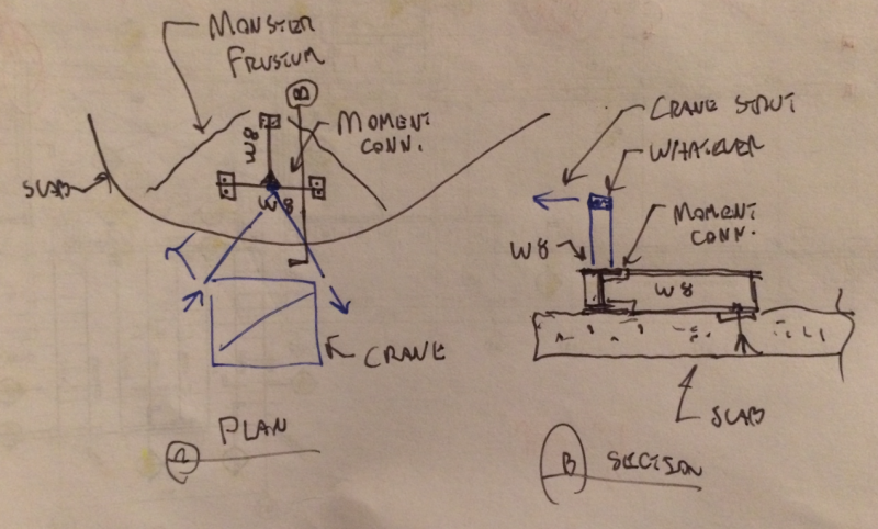

I have received the submittal for the tower cranes of a 22 story flat-slab building. As expected, the manufacturer has identified a couple of locations where the crane will need to be tied to the building for lateral support. In addition to placing the lateral forces in my slab, the manufacturer is also specifying a 1-foot vertical standoff for the connection plates (for a total eccentricity of 1'- 6 1/2". This is outside my wheelhouse, and I want to make sure I am checking all the failure modes and that my methodology is reasonable.
I am going to/have checked the following failure modes: concrete bearing failure of the through-bolt sleeves, concrete breakout of the connection, two-way "punching" shear at the anchorages. I am checking the bolts but not the connecting plate assembly (I am going to put a CYA note on the submittal about it.) I think the checks of the bearing failure and two-way shear are straight forward out of ACI. The concrete breakout has me scratching my head. The one person in my office that has checked this condition for this type of structural system used the Hilti Profis software and ACI App. D to derive a breakout value, but App D specifically precludes conditions with through bolts. The only step I have from there is to apply the cracking strength of the concrete (either 7.5 root f'c or 5 root f'c) to an assumed breakout surface. I have used this method with a 35-degree angle similar to the App. D assumptions. It worries me that this capacity is so much higher than the capacity predicted by App D.
Finally, The height offset is proving difficult to resolve. Initially, I thought that the through bolts and the sleeves would cantilever and the offset would be little more than a shim, but the sleeves fail miserably as cantilevers. For a concrete solution, the interface needs to be reinforced to transfer the 340kip of ultimate shear acting concurrently with 520 kip-ft of moment. The required reinforcing just to satisfy shear friction makes a chunk of concrete extremely impractical to serve this purpose. The only thing I can think of is to provide a steel plate "chair" fabrication to transfer the shear first to the "chair" then from the "chair" into the slab using the bolts. I have checked the specified bolts for the combined tension and shear force using AISC, and it works, but I am not even sure if that is the appropriate code to use for the design of elements like this.

I have a number of thoughts but you're not bound to like 'em.
- In general, I think that you've got your bases covered with regard to the checks that you're doing with one possible exception. I believe that you should also check your slab for the bidirectional moment likely to be induced at the anchorage. That, particularly, given that are punching shear provisions assume that complementary and competent bending reinforcement is provided where punching shear is checked. Insufficient slab flexural capacity = bunk punching shear capacity. The University of Michigan tested this out for us a while back creating a rather large kerfuffle. Probably just means some concentrated top and bottom steel at the anchorage locations. No biggie.
- It worries me that you seem to be evaluating punching shear for the slab moments concurrently with breakout for the shear parallel to the slab. There's got to be some manner of interaction between those two failure modes as there would be if you were doing App D stuff. Especially if you need to crack out the concrete breakout frustum a bit before engaging supplementary rebar.
- I pretty much refuse to through bolt nowadays for serious loads. That, simply, because there is no accepted design procedure for evaluating through bolt connections that I am aware of. All I know of is this: Link. Given how terribly wrong we all seemed to be about anchorage pre-App D, I find the notion that we could somehow "first principle" our way through something like this to be very suspect.
- While I often hear of engineers using shear friction to help with concrete breakout situation, I'm not a believer. Firstly, the load is predominantly perpendicular to the shear plane rather than parallel to it. Secondly, I believe that slip along the shear plane would put your SF reinforcing in compression which is a no no per ACI 318-14 R22.9.4.3. Lastly, you'd have to crack the concrete in order to engage the shear friction reinforcement. That might not go over so well with the owner.
- Like your chair idea, you may want to construct something of your own that distributes the anchorage loads to your slab in a more favorable manner. The sketch below shows a rather extreme solution for a steel framed building where it was decided to bypass the deck slab altogether and attach to the shear walls directly. That would be much too extreme for your situation of course.

TLHS: Here is a page from the submittal with the configuration indicated. I think the only issue with their drawings is the Detail C doesn't properly reflect the condition with the slab and the 1-foot fill. I will also note that my slab is 8" thick and is post-tensioned.
KootK:
- I am going to throw the induced moment into my floor plate model and see what additional reinforcing I need to add to get slab to resolve the moments. I completely neglected to mention that in the OP.
- I am a little confused about your second statement. Did you mean not concurrently considering the breakout and eccentricity induced moment? I honestly had not thought to combined the two. Now that you raise the interaction issue, you are right there should be some interaction effect, but there is no guidance on how to account for it unless I just use the App D. interactions. Two things occurred to me in regards to this on the drive home. (1) It might be worth it to use the plane concrete chapter and evaluate the surface of the "shear failure cone" for the combined tension from the induced moment and the breakout tension. I was just going to evaluate a polygon offset from the "chair" structure plus half the slab depth. (2) Err on the conservative side and provide enough localized reinforcing to develop the entire shear "tension".
- I agree that trough bolting seems an abyss of nothingness. I am worried that once I say "through bolting is not acceptable" the manufacturer will throw responsibility for everything after the connecting strut back on me. I know they have a mountain of previous applications using this method, and I am loath to "poke the bear" as it were.
- I was only thinking of applying the shear friction provisions for the cold joint between the top of my slab and the 1'-0" required offset shown in Detail 2, assuming the offsetting material is concrete.
You sketch is effectively what I am planning with the Chair. I am just going to use the 8 Connecting bolts/rods.
Robert Hale, PE

Agree re bear poking. I'm okay with others through bolting so long as they're taking responsibility for it. In fact, I welcome the opportunity to review their calc methodology.
I was thinking of something else on the shear friction front. Consider my previous comment redacted.
