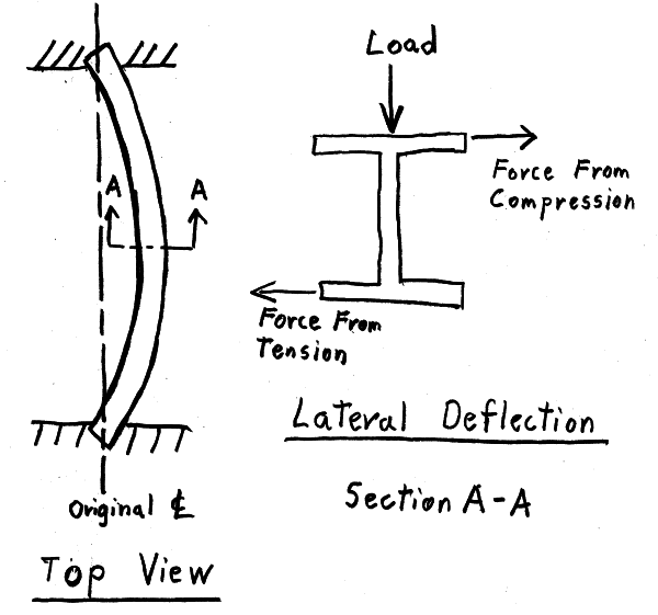

Lateral deflection and lateral torsional buckling (LTB) are caused by the same thing.
Consider a simply supported, wide flange beam, that is straight, with no applied load. The beam is "long" and has no lateral support.
As vertical load increases, the first indication of problems is the entire beam's uniform lateral deflection.
The compression flange has deflected the only way it can - sideways.
Tension in the bottom flange tries to pull the beam back to it's original center line. The beam's inherent torsional resistance keep the web vertical, but cannot prevent the lateral deflection. See my sketch:
As load continues to increase, compression force (pushing one way) and tension force (pulling the other way) overcome the beam's torsional resistance. LTB begins and the beam begins to twist. How the vertical load is applied to the beam begins to matter.
When load is applied to the top of the beam, this is a destabilizing force (an eccentric load). Compression force and the destabilizing force "team up" to make LTB worse.
When load is applied to the bottom of the beam, this is a stabilizing force (still an eccentric load). However, in this case the stabilizing force tends to resist LTB. LTB is still occurring, but is not as "bad", for the same load magnitude. See this sketch:
The intent of any lateral or torsional bracing is to keep the compression flange straight, and along it's original centerline. The tension flange keeps itself on centerline.
How to accomplish adequate bracing is the subject of much technical discussion. If enough (very close together) lateral braces are provided directly to the compression flange, the compression flange stays on centerline and the beam fails in bending without LTB issues. In many cases a compromise is possible. Enough, but spaced, lateral compression flange braces can be provided to allow the beam to develop sufficient moment resistance for it's job before LTB begins. Sometimes, compression flange bracing is not an option... therefore torsional bracing.
